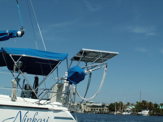

I have 2 - 130w Kycera panels with a Sunsaver mppt controller. The system works great to keep the freezer/refrig cold plus what lighting we use at night. By the end of each day, I am usually back to about 98% of our 520ah house bank.

The Kyocera is one of the few makers of solar panels with a warranty covering use in a marine environment. That's important as your panel will be on the boat for a long time and you want them to last. I've had the Kyocera 130 watt panel on our H386 for over 5 years and it's as good as new. I use a Xantrex C35 controller as I thought at the time I might wish to add additional panels which the C35 could handle. I don't have anything on the Blue Sky 2000 controller, but I hear good things about them. Just ensure it can handle the load you intend to put on it. As for proper wiring, it's hard to tell where to connect the wiriing as each boat has it's own issues. I'd recommend you find a local pro who can do the final connections. Best wishes. You'll like the freedom a panel gives to your batteries. They're always happy, because they're always full!

We have 2 Kyocera KCM85 85 watt panels, the Bluesky 2512 mppt controller and remote display servicing 4 Trojan 605 batteries. We installed the Trojans 3 years ago while cruising FL. We kept them serviced with the engine generator and a Honda 2000. Although the setup worked fine it seemed we were spending a fair amount of time baby sitting the charging process. Two years ago while cruising FL once again, we installed the solar system and have almost eliminated the Honda's use. As Ron said, the batteries stay "happy". This setup keeps up with our demand which includes refrigeration, lighting, stereo, computers, radio, and the most important Admirals TV.
