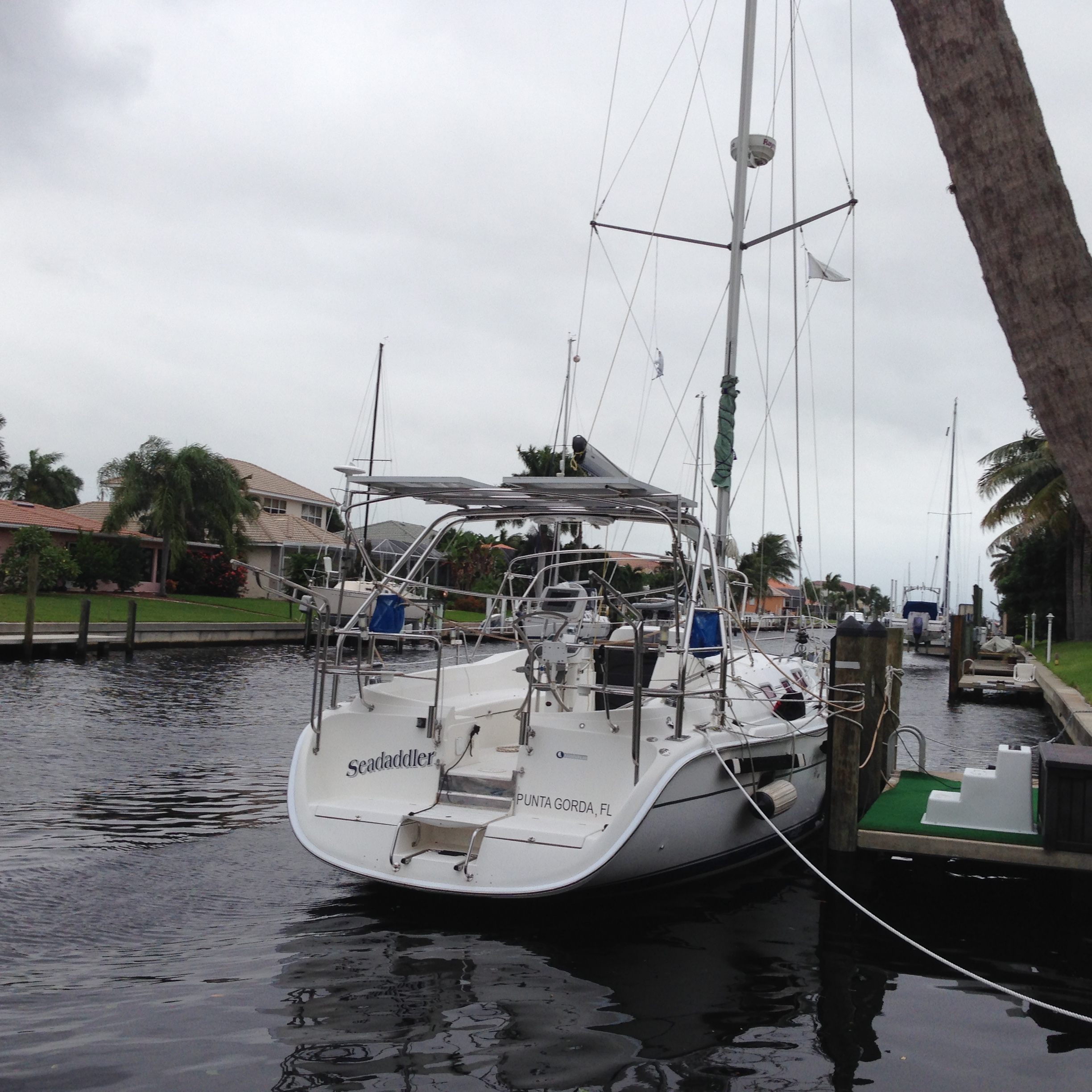

hi, I’m interested in adding solar power and am interested in seeing how other 356’s have set them up as well as any helpful hints. Thanks.

Thanks that looks great. Are you still able to put the Bimini top on the rear portion?

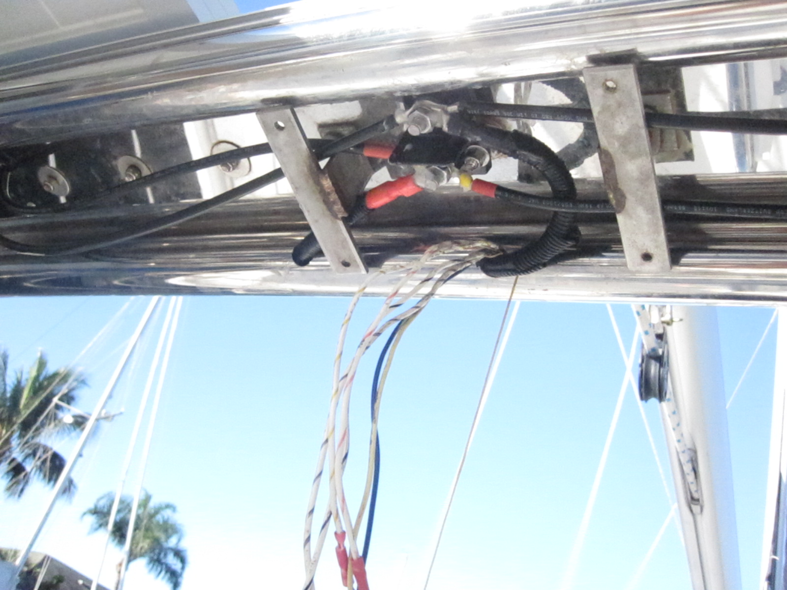

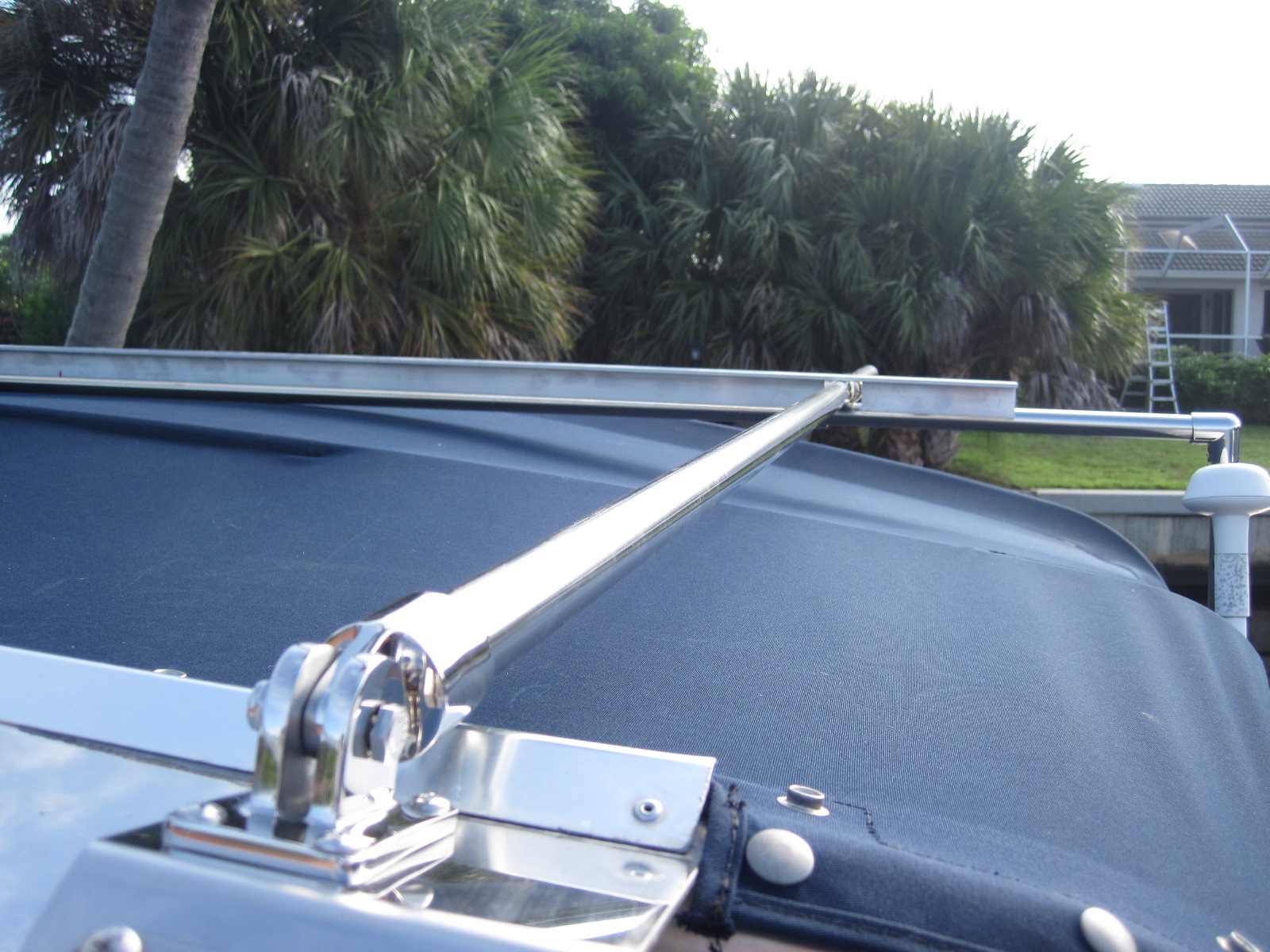

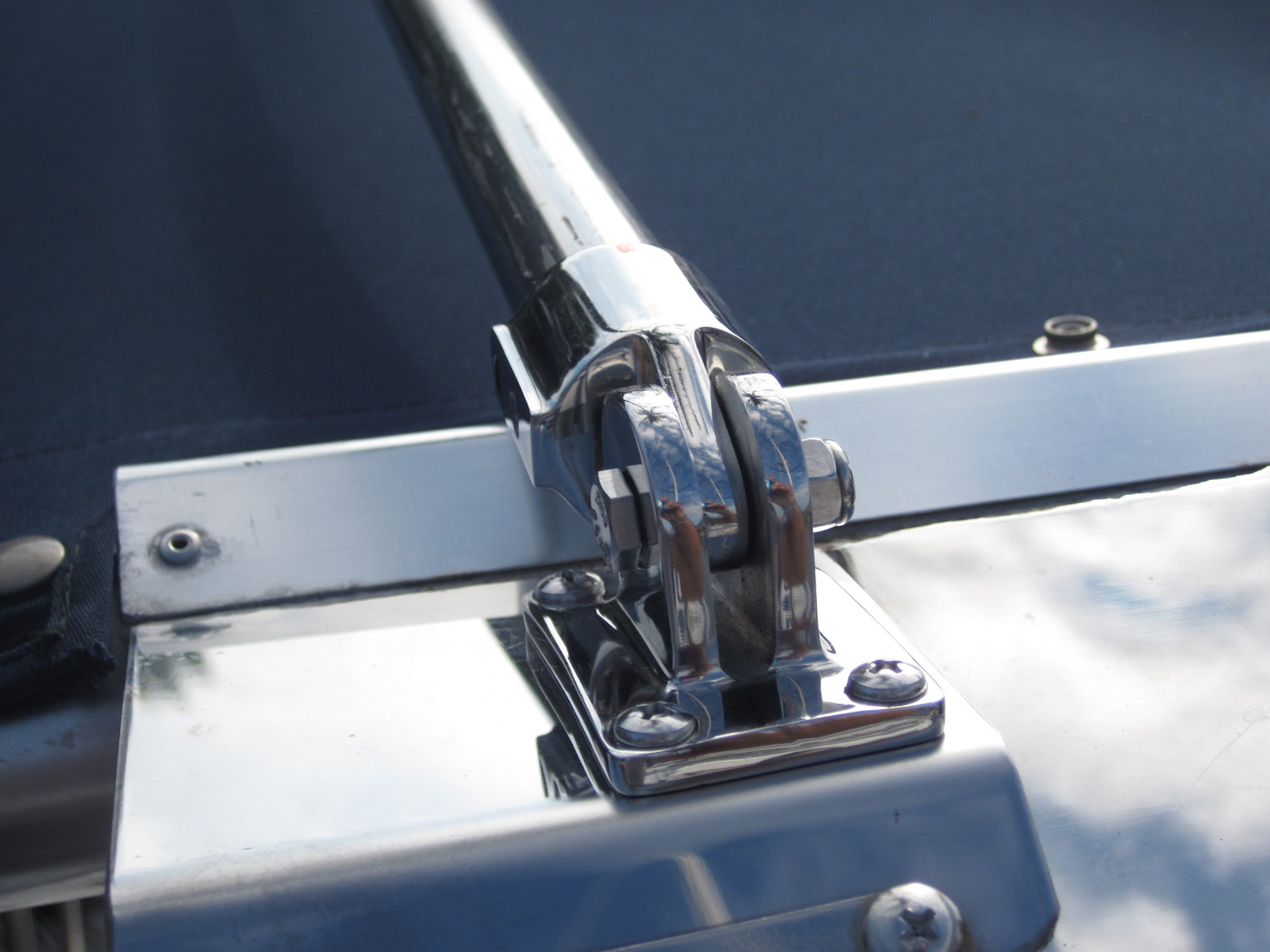

I take all my canvas off in July and August and Sept and do not remove the solar panels,I go north in my MH.
No problem removing my Bimini a few times to spray 303 water proofing.
I did use aluminum angel but wish I used more of the round stainless only to make cleaner look, but the aluminum helps keep the panels strong and they never move and never even shake.
