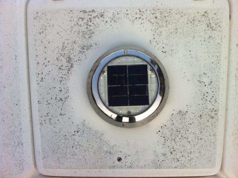

I have one of those Nicro, Day/Night solar powered vent fans.
I can't hear or even feel it running, so I always wondered if it was worth having.
While working on my boat this weekend I decided it was time for a past due cabin clean up. The walls had junk left over from leaking rubrails, the ceiling was filthy, generally it was a mess.
I noticed in the rear portion, Id say from the aft bulkhead (at the mirror) back, there was a lot of black spots. Mold I guess. Most of it just wiped off with a wet rag but there was NONE, forward of there.
My vent fan is in the hatch over the V berth. Funny thing, on the outside, on the deck there is a clean area just outside the fan, and then a few inches out from there is the same little black spots in a ring around the fan!
It looks like the fan pulls enough air to keep the mold out of the front area, but it just transfers it outside on the deck. Weird, I wouldn't think it could live out there.
At $140.00 those things are expensive but now that I've seen that, I might add one more somewhere in the rear.

Here's a pic of what I was talking about.
Maybe it's not mold but just dirt? My boat really needs a bath!
