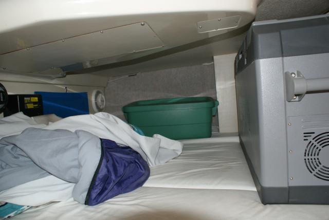

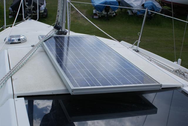

As an H26 owner with a 12/24/110V cooler/freezer on board I find a 90 watt solar panel with 2 G29 batteries provides enough power to keep frozen stuff frozen and can even refreeze gell packs for the cooler in the galley. On low sunlight days the 15amp alternator in the 15 hp merc out board brings the batteries back up in 2-3 hours of motoring. So you see you to can have your comforts. Gary.

what are you using for a freezer ? what size is it ? where do you keep it on the boat ?
Thanks, Bob
It's WAECO #CF110C110 112qt and can be found at west marine for959.00. I got mine from a rv dealer last year for 1000.00cdn. I keep it in the aft berth, you do have to tun it to access the inside but this spot keeps it secure in rough weather. This spring I'm thinking of opening up the vberth and mounting the freezer under the cushions. All that is there is water bladders and air, lots of space for the freezer. Wiring the twin batteries; main power/outboard charging though 3 way power switch, off/bat1/bat2/both/. Solar from panel regulator to high amp diodes at each battery, low flow(amp)resistor on one battery to provide voltage sense for regulator. Both batteries charge at the same time on solar and either 1 or 2 on outboard, operators choice depending on state of charge of battery(ies).

thanks !
great idea, it should be even better when mounted under the v-berth,

Hey Sum, that is a neat genset you built, I'm afraid I have too much stuff hanging off my stern and rails to add a genset like yours. I found a pic of the solar panel mount, I still have room to mount another panel if I need to without banging toes on the foredeck. You guys south of the 49th are lucky with all the low prices, everything up here is big bucks! Gary
