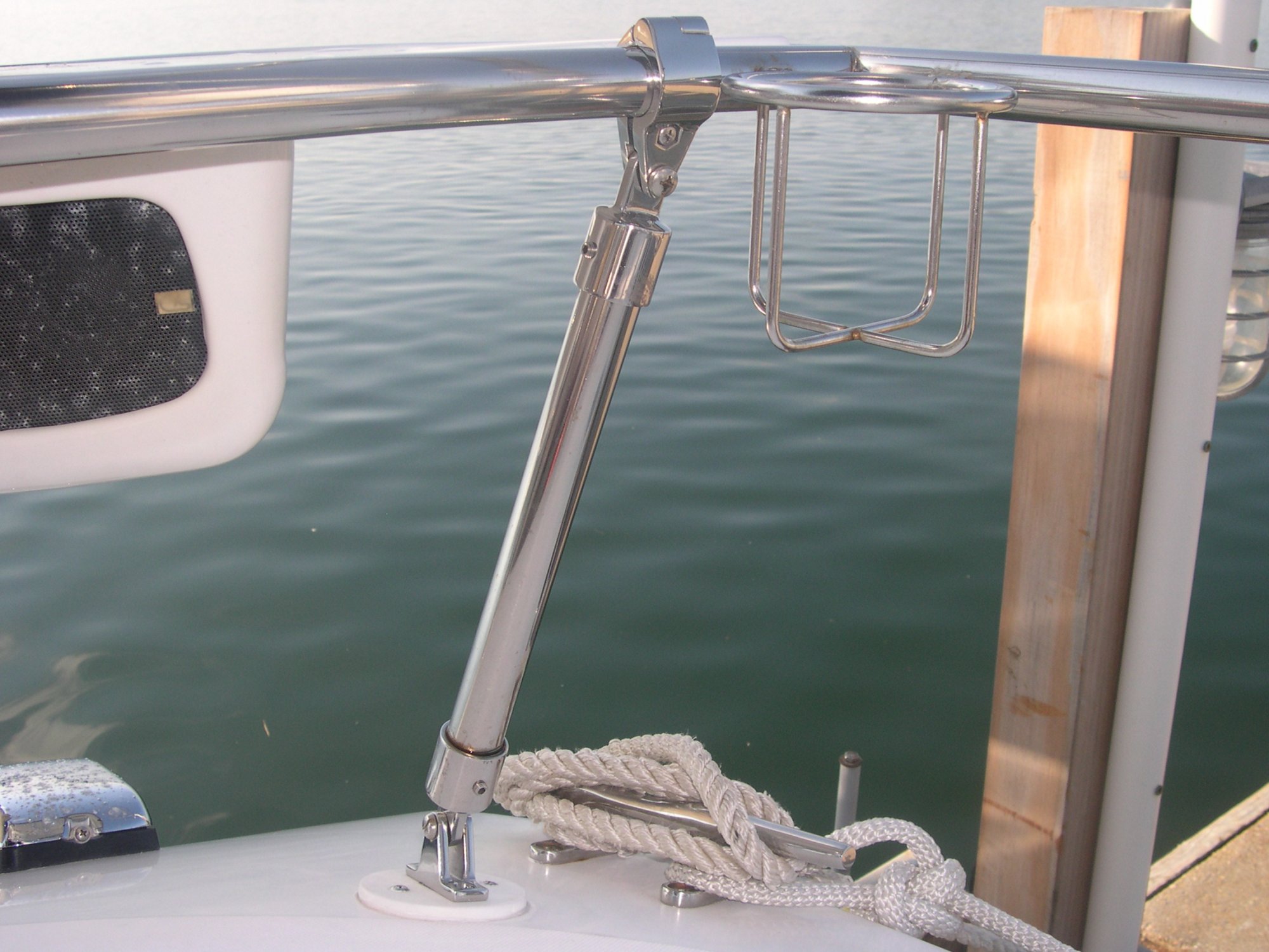

The problem: the seats overhang the cockpit and transom. Which interferes with the placement of the front leg. The front leg must go on the hull, like this, or very far aft/down the sloped transom. Here is a hull mount picture from Atlantic Tower's website:

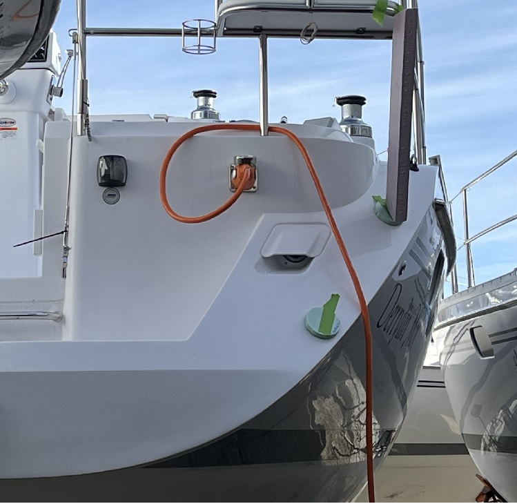

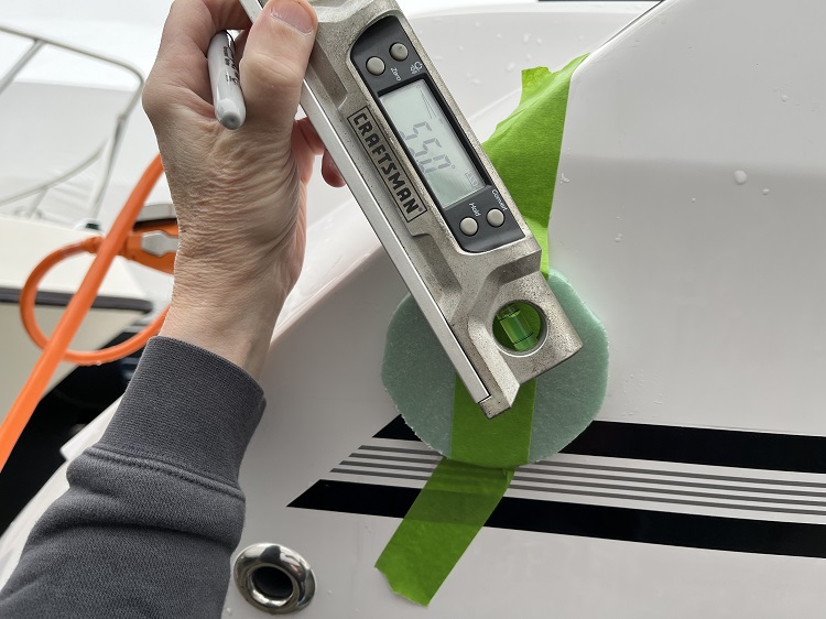

The next problem: the starboard cabin bulkhead is very far aft, which limits how far forward the leg can go. Combined with the steep slope of the transom, the best I could do was to mockup the attachment point with a 4” disk, shown in the picture. The front leg is constructed 35 degrees to the vertical (55 degrees to the horizontal)
Which leads to the next two problems. First, the curvature of the transom means the rear leg span is more than 24" narrower than the front leg span. Second: the rear leg ends up pretty far down the transom
Atlanitc Towers said they could custom build a tower with 24" difference between the front and rear legs, vs. the standard offset of 12" (TIB1015/025SPO1 - TIB24600). So this problem could be solved.:)
But ultimately, I didn't like the overall placement of the rear leg being so close to the water line. In this picture I slid the forward leg mount point aft, to attempt to clear the seats. And the rear mount point is pretty far down. Even moving the mount point to the hull, did not improve this, because the internal bulkhead limited how far forward/up the front mount could go. It's a wash. :(

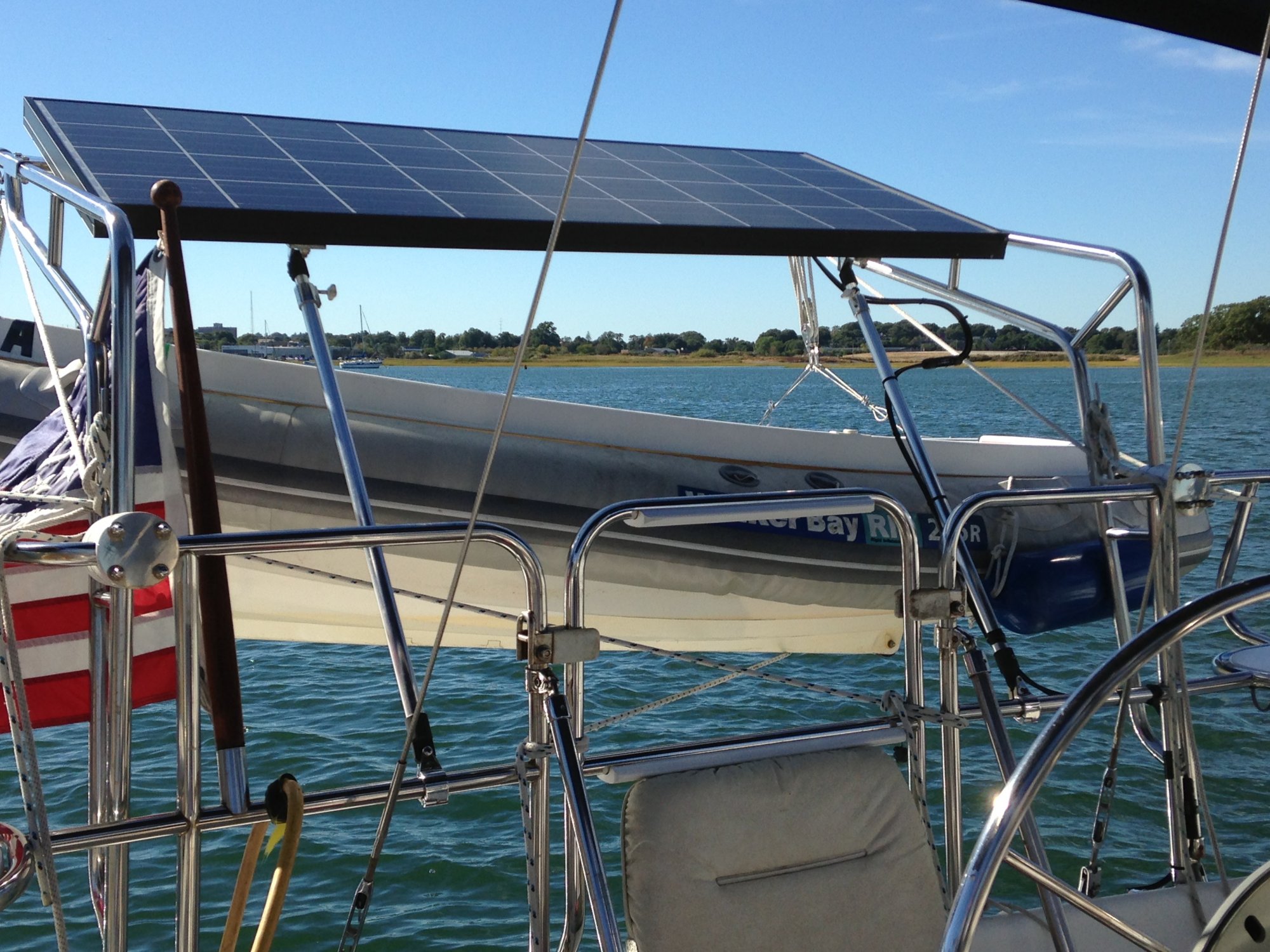

Not sure if this will help you, but you could fabricate something like the davits I installed on my C310, that are secured to the stern rail. Maybe extend the frame higher and put on a platform for the radar. I added small stanchions for support, and used starboard pads under the feet.DSCN1238.JPGIMG_0200.JPG

Not sure if this will help you, but you could fabricate something like the davits I installed on my C310, that are secured to the stern rail. Maybe extend the frame higher and put on a platform for the radar. I added small stanchions for support, and used starboard pads under the feet.View attachment 221868View attachment 221869
Tom have you notice any differences in the boats handling with the davits and solar panel compared to without the davits.
Tom J
Sep 30, 2008
2,325
Catalina 310 Quincy, MA
Yes, but I don't race, so the overall performance was acceptable for me. The main issue is fore/aft balance. I had put some old anchor chain in the anchor locker as ballast, and I kept all my heavy spare parts under the forward bunk. The dingy I used was a Walker Bay 8, so very light. I mainly lived aboard and cruised, so the hull normally sat low in the water at all times with the added weight of stuff, and the windage of the davits and dingy wasn't really detrimental. In addition, the solar panels tilt forward and aft, so they would be in a horizontal position when sailing or motoring, thus limiting windage.
