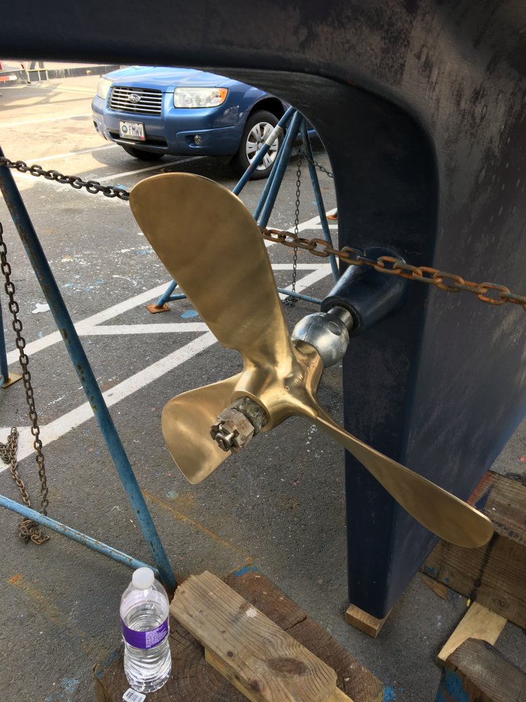

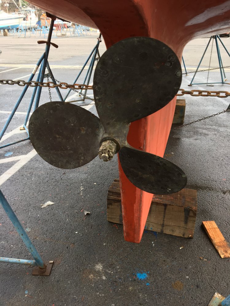

Hi Guy,
My experience with my previous boat, a 1991 Cat30 MKII has shown me that I really have a choice of only 2 sized props. The 13x10 three blade is the OEM on this boat. I tried a 13x12 three blade and actually experienced a little more speed and just a bit less walk. The differences are truly minimal, but if you are under power as much as I am in order to clear the mooring field and very busy channel, you can feel these differences. Both of these props are "Mickey-Mouse" eared. The latest boat I now have is a 1997 Cat20 MKIII with an OEM 13x10 three blade, but has much narrower blades. I have yet to experience any under power maneuvers, but I can tell you that speed is an advantage and there seems to be less walk. Good luck and Happy Sailing.

Matt, my boat pulls to starboard, only at higher rpm, and I can counter the pull with two fingers on the wheel, I have the big ears 3 blade prop.
