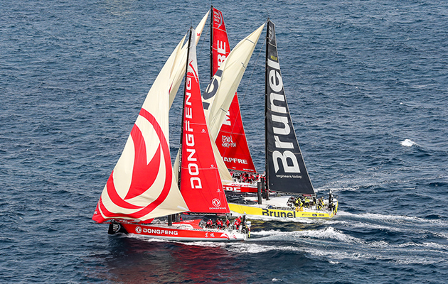

Not the best photo but close to the condition I was describing. This looks like the flat top is 75 degrees from parallel to the center line of the boat

The VOR boats were so fast downwind sailing became a beam reach because the apparent wind moved that far forward. If I recall correctly none of the boats ever flew a spinnaker, it was always a Code 0 or similar sail. The other factor is mast height. Wind 100 feet up is always a different and faster, thus the upper part of the sail is trimmed for down wind while the lower sail is trimmed for a reach.

The flat head on the main shows the twist off much more distinctly than the traditional cut main. Note the VOR flat head sails have a much greater roach at the head sail. This may be a factor, why they are sailed with what appears great amount of twist.
I would not think using this large twist is a target to emulate on a different boat using a traditional sail cut.

The boats in your picture look like a broad reach in light wind. They have the big genoas out which aren't entirely full. I'm guessing a lot of shear.
14,214
There is a lot of disturbed air because the boats are so close to each other, that will account for the headsail shapes.
