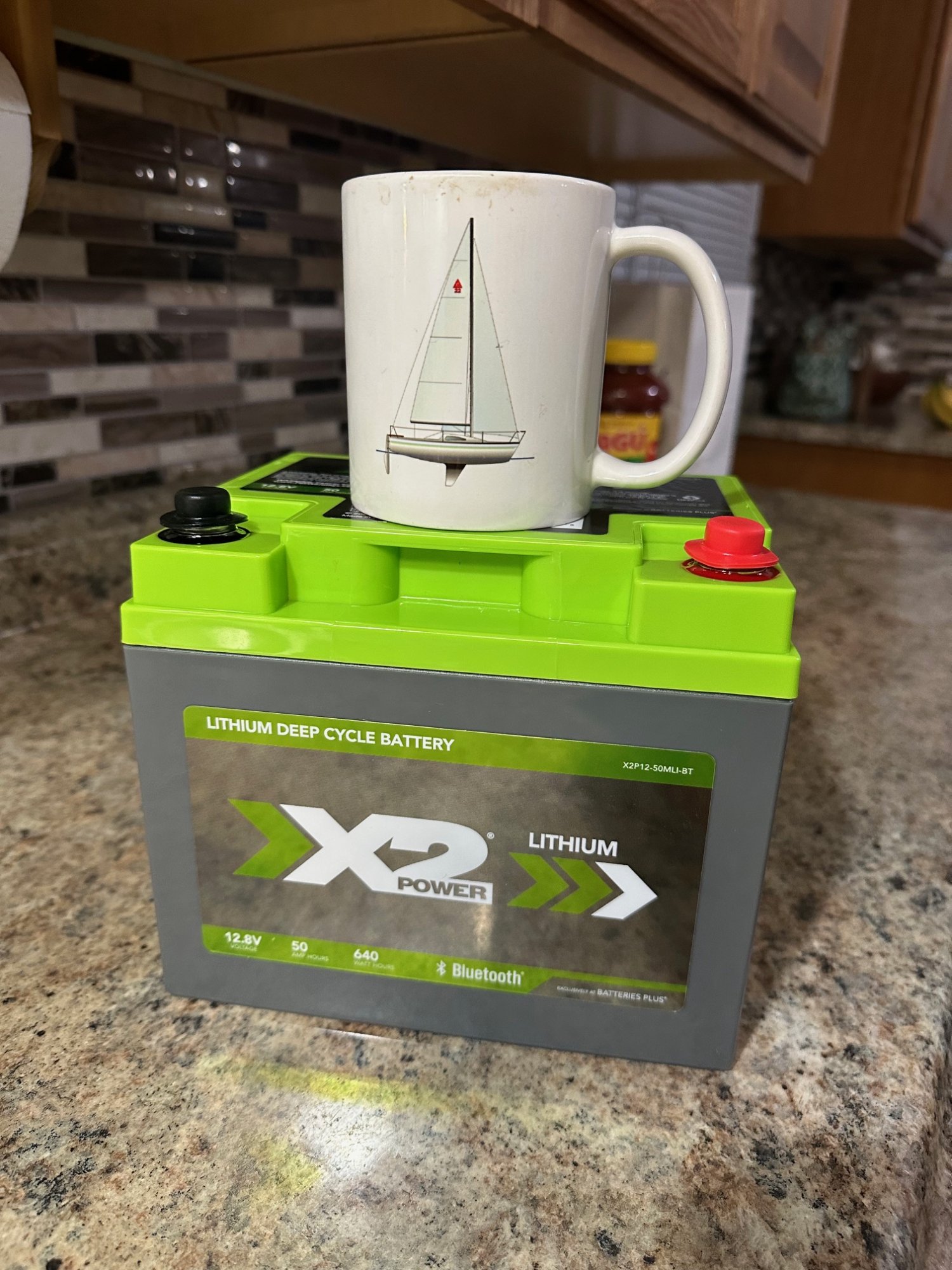

So, I pulled the trigger on an "X2Power" lithium battery.
Sep 30, 2013
3,642
Such a cute little thing! :biggrin:
It's 33 pounds lighter than our beloved Trojan FLA battery, has about 18% more usable Ah, supposedly charges four times faster, and comes with a 10-year free replacement warranty. It is Bluetooth equipped and can be monitored on your phone. It protects itself against over-charging and over-discharging, and it thrives on a partial state of charge.
All those things, plus a cocktail or two (or four) finally made me click the "buy" button. :thumbup:

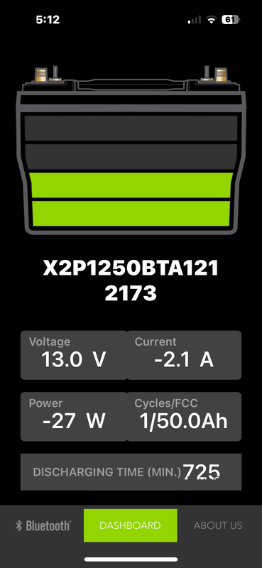

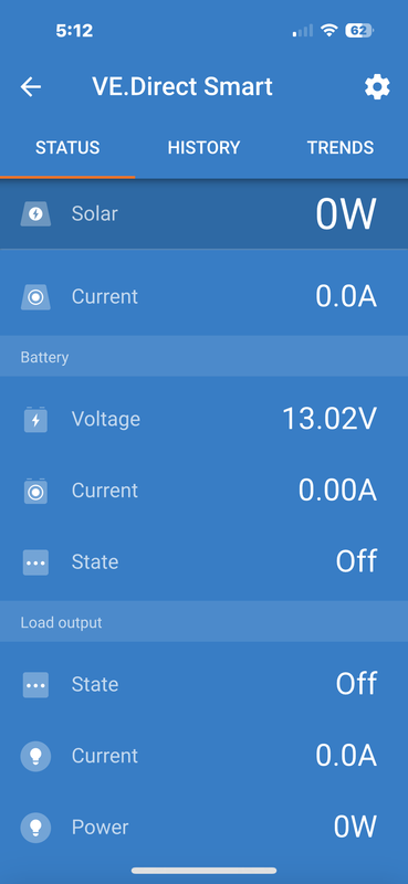

Screen shots from the X2Power app and the Victron solar controller app. Nice to see they are within two hundredths of a volt on the battery. :thumbup:

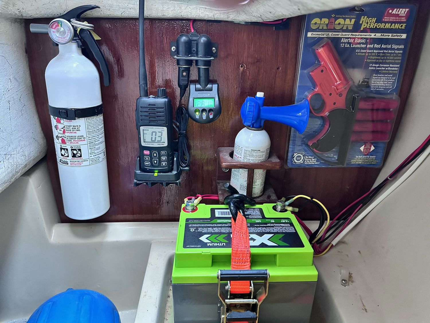

As an aside your flare gun will not count toward meeting the requirement if it is still on the package. A great way to organize and store them and I doubt there are many guys who are enough of a jackass to actually cite you but forewarned is forearmed.
Feb 28, 2022
213
Catalina 22 12482 Champaign-Urbana, IL
I can TOTALLY see why that is the case. There was an episode of the TV show “Curb Your Enthusiasm” about these plastic wrapped packages and how hard they are to open.
Sep 30, 2013
3,642
Thanks for the heads up! I had not heard that before. I think I'll be okay though. Although you can't see it, the package is already sliced open all the way up and down the right side. (I've had to replace expired flares a couple times.) I can pull the gun and flares out as easy as pulling a letter out of an envelope.

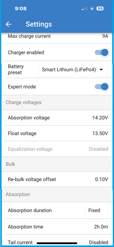

I'm hoping to charge it the same way we've always charged the FLA Trojan: two articulating 30W Renogy panels on a Victron controller. I deliberately ran the battery down overnight last night, and now I'm watching to see what happens. I've set the controller to the "Smart Lithium" presets, but I need to dig deeper and make sure Victron's default settings (found under "expert mode" on the controller menu) are 100% ideal for this battery. The battery manufacturer doesn't publish this data anywhere I've been able to find, so it's probably going to require some phone calls.
These are the settings as they are now:
13,436
The X2 website is a bit short on useful information. They claim the battery has 640 watt hours of capacity (roughly 50ah). Your panels under ideal conditions can produce 60 watts, so under ideal conditions it would take 10 hours to restore the batter from 0%SOC to 100%SOC. Realistically, even in Florida, you'll probably only get between 180 wh to 240 wh of power from the panels. That's 3 to 4 times the nominal panel output.
The 14.2v charge is probably fine.

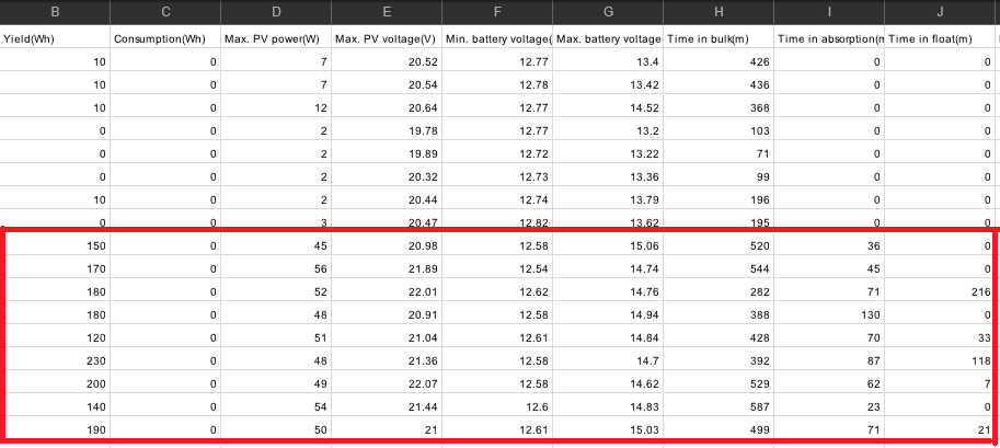

You are spot on with 180Wh/day as a minimum. Our real-world solar yield, measured in late December (shortest days of the year), in typical mixed clouds-and-sun weather conditions, averages 175Wh (14.6Ah) per day.
More than enough for our needs.
In the table below, the area in outlined in red shows the solar yield data, collected over nine consecutive days (December 15th - 24th). As you can see, the battery voltage at the end of the cruise is the same as it was at the beginning. :thumbup:
Good to hear. Same thing applies to PFDs and any other required piece of equipment. Seems sort of silly a vinyl bag closed with heavy duty Velcro is ok, but a flimsy plastic bag is not.
And while on the safety gear nerd rant. You are probably going to anyway but covers on the battery's terminals or a covered battery box are a very good idea.
