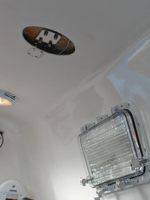

I found this of someone's traveler installation from years ago, I remember he used a hole saw to cut this out and then install a round inspection port to cover it up, might be something to consider.

I have a question about dkeagle's photo. Where is the balsa core between the deck and the
headliner?
Oct 6, 2007
1,152
Hunter H30 1982 Chicago IL
Azambella,
The core, whether it's balsa or plywood, is within the deck. In dkeagle's photo, you are seeing the fiberglass underside of the deck through a hole cut in the headliner. There is nothing but air between the deck and the headliner. That is the dilemma.
