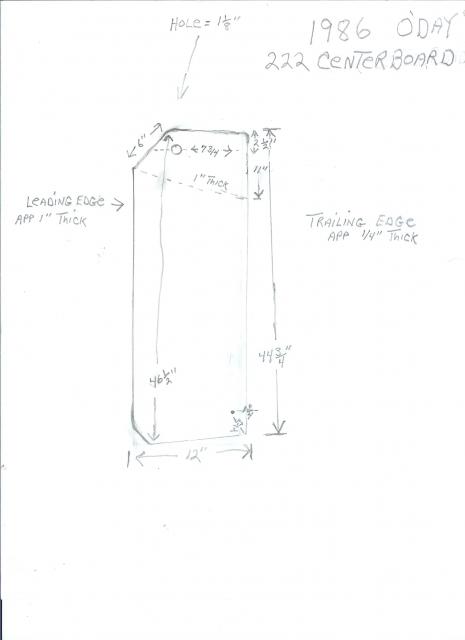

Fred,
Here's a sketch of my O'Day 222 Centerboard if that will help you.
