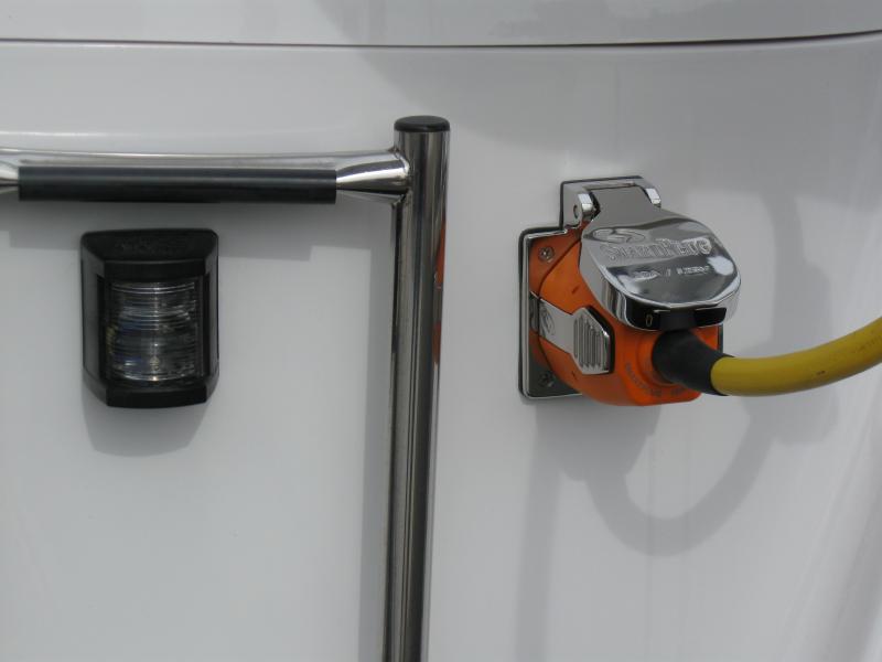

I have to admit putting the Smart Plug connector (retro fit) on the cord was challenging. Installing the boat side inlet was a snap, comparatively. Total time was 3 hours (about 2 hours for the connector and 1 for the inlet). A local marine electrician cautioned me to "Read and follow the instructions". I am happy with the results.
