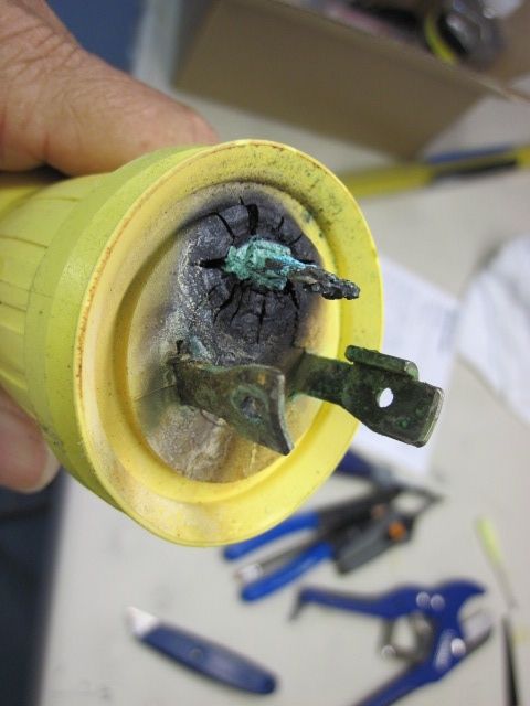

Picture is a friends power cord. If hadn't been on the boat at the time he would have gotten watch it burn to the water line. He was very lucky...
