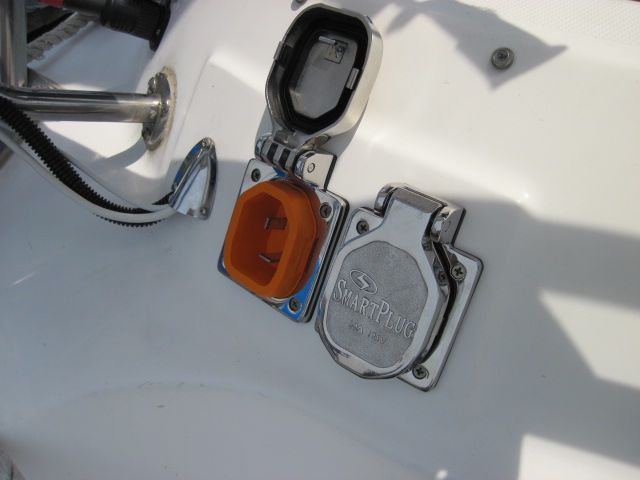

Went to install my Smart Plug inlets yesterday and got a surprise. The 10/3 wires were just long enough for the current installation. Couldn't get an extra inch out of it. The manufacturer did not waste a half inch installing the wires. Now I've got to get some butt connectors and wire and add say 4 inches to complete this.

I'd try to avoid splices in un-fused wire. How far is it to the breaker? It could be better to replace the run of wire. Otherwise be sure to use high quality splices with insulation support and a quality crimper.

Hi Ken, The breakers are about 3 ft from the thru hulls but is protected behind a glued in shell. Didn't try to pull out the breakers to see if I could get to that side of the connection.
Will be using good quality wire and shrink type butt connectors with the right crimper and more shrink over that. I do listen to Mainesail when it comes to this stuff

Pictures to follow....
Mar 21, 2004
2,175
Hunter 356 Cobb Island, MD
Pictures in album
http://forums.hunter.sailboatowners.com/album.php?albumid=3243
Not happy how the sequence of pictures turned out in the album. Anyone know how to re-arrange them?
Install went well, no problems. The wire length from the power plugs to the circuit breaker were cut to the 1/10 of an inch. could not pull the circuit breaker out enough to remove that side. So I was reduced to installing the shrink butt connectors to lengthen the mess, but that was minor. The new Smart Plugs installed just like they said they would.
