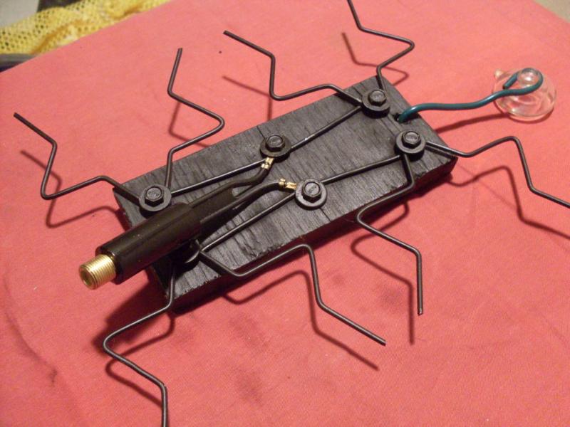

This is hands down the best, costs next to nothing antenna I have ever used. I have one on a pvc pole running my whole house and several with a suction cup added (see picture) so I can stick it in a window or other flat surface when in the boat. No power needed. Made from a coat hanger, piece of wood and some screws. The fractal design allows it to be wide banded while also being really small (approx. 6"x7").
Cheers,
Brad
