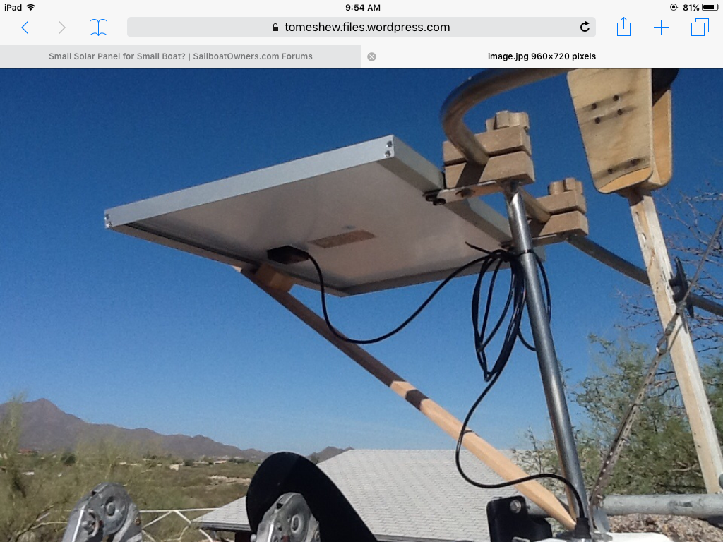

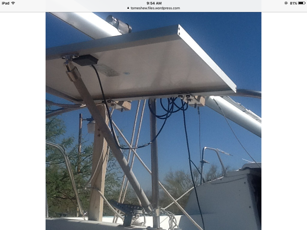

Lots of ways to do this but I will throw out a couple ideas. These mounts are based on these Seadog rail clamps http://www.sea-dog.com/groups/2833-removable-rail-mount-clamps They have some different versions that might suit your application better.
The second picture shows the 20 watt panel "cantilevered" but I found that the wind would change the angle so I added the adjustable lenght brace in the first picture. This allows the panel to have one axis of angle changed with two screws.

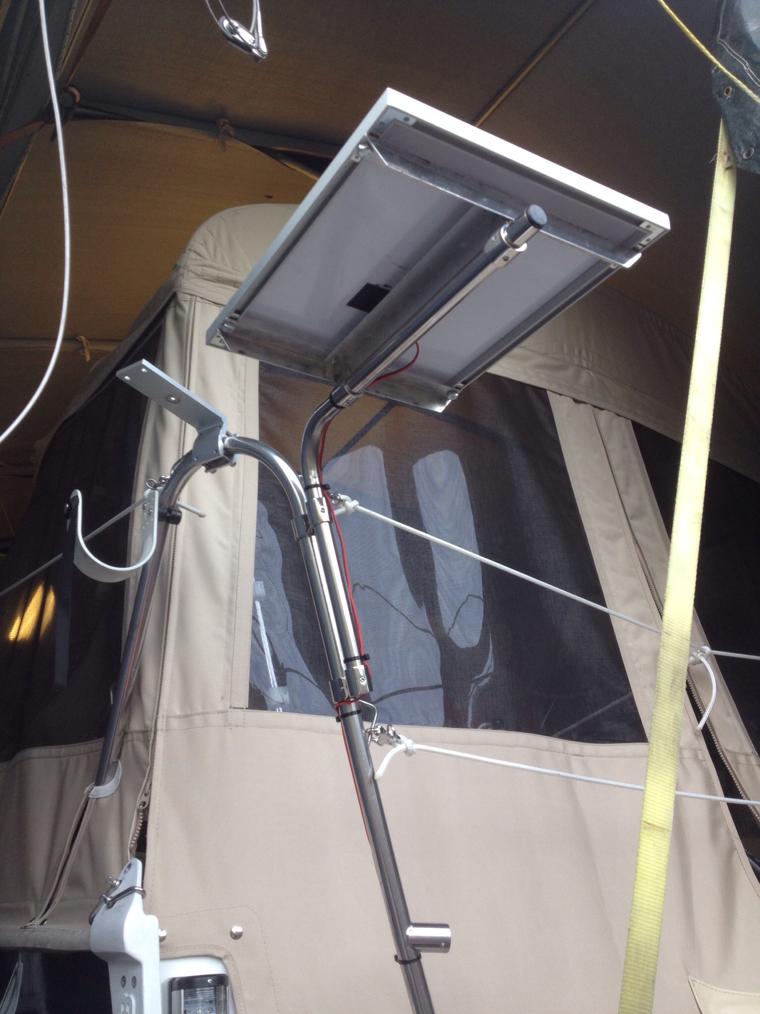

Here's what I did. Pops off for trailering pretty easily. Machined from Trex-type fake wood. The supporting rod is no longer wooden, but is from an old one inch spreader with stainless hardware. Maybe I can find a newer photo.
I think I'd do well to upgrade the connector on the transom from the two pin 12 volt to something more weather/corrosion resistant.

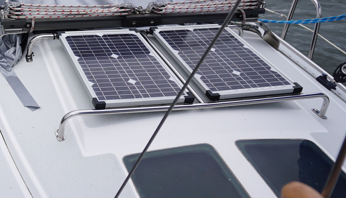

Here's 2, 35w units on a custom frame in front of the traveler. While they are not always fully exposed to the sun, they are out of the way, and after two years seem to be maintaining the batteries.

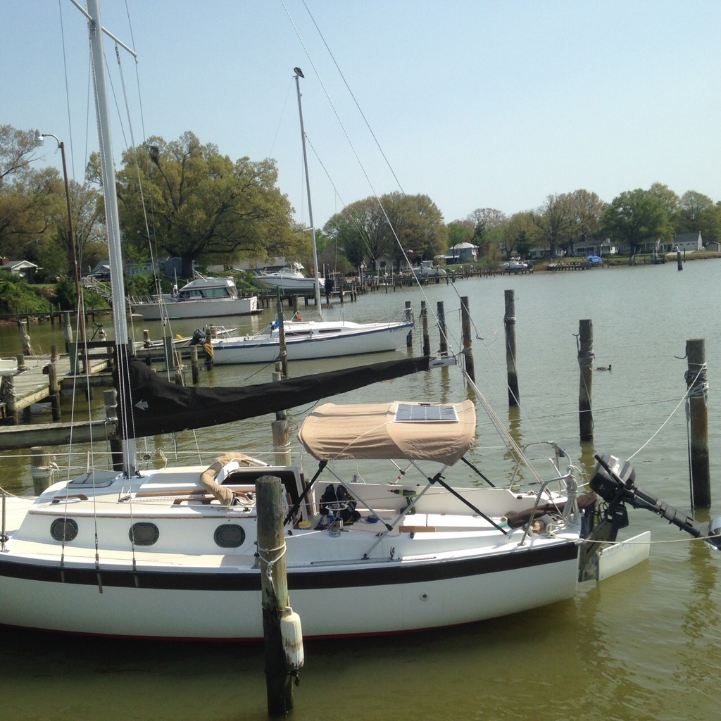

I am a little opposite. My 23 has a 100 watt semi flexible panel that rides on the bimini when I am on long trips. It is Renology and the charge controller is a Genasun GV10. I really like this set-up and I know that most of my power needs are met on my extended cruises.

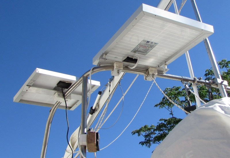

Can swivel them to the sun if need be, but I haven't to this point.The function of these two stern mounted panels is to top up the house battery bank in between sailing days. They work very well and are on a single charge controller.
I have the same set up for my bow thruster battery.
