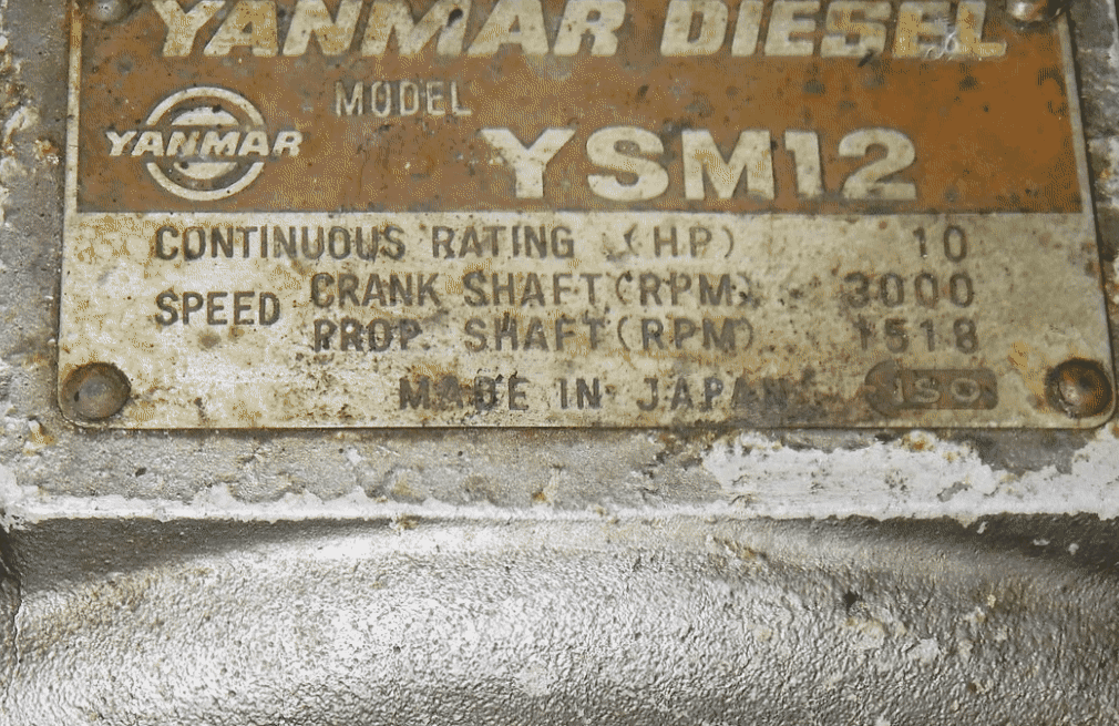

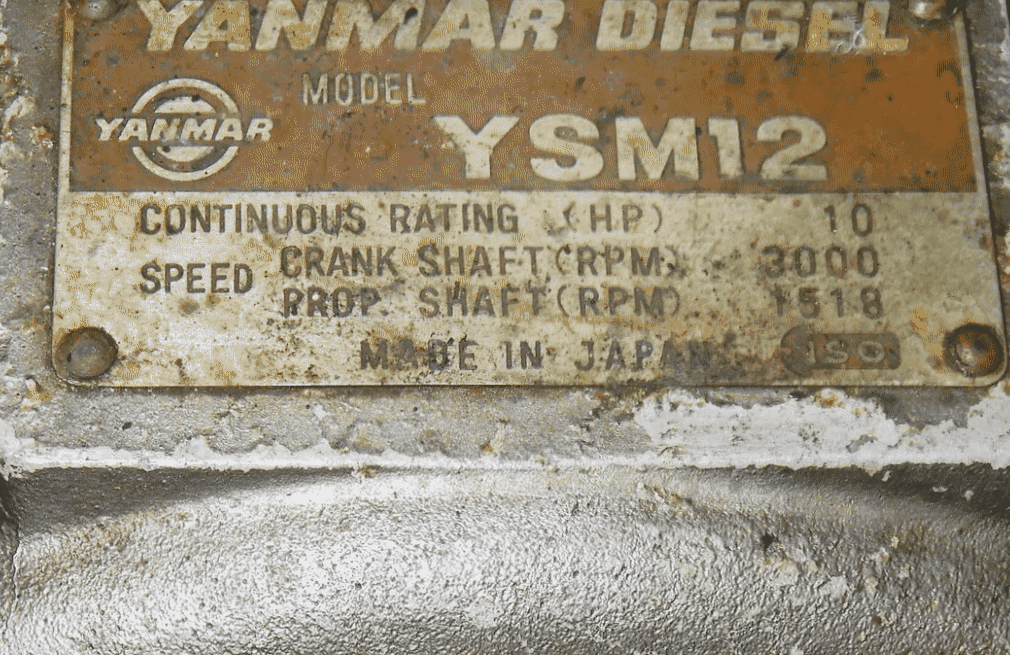

Finally made it down to the boat. Checked the engine plate, turns out it is a Yanmar YSM12 after all. Checked all the wiring as some of the posts suggested and found that the black wire that Connects to the engine was heavily oxidized. It was So badly corroded that when I started to remove the bolt which fastens it to the engine, the terminal end broke off. Unfortunately, as I tried to reconnect with a different/spare wire To see if this was the issue preventing ignition the bolt slipped and I dropped it.:doh: No idea where it landed. Looked for it everywhere For a good 20 minutes, stuck my hand in every little nook and cranny to no avail. The bilge troll must have taken it.:what: Now I’m in need of a new bolt. Any idea on why size/threat Type that bolt may be? Still haven’t found a manual for the ysm12 to be able to look this up.Will update on progress (or if troll gives me back my bolt:laugh:)
