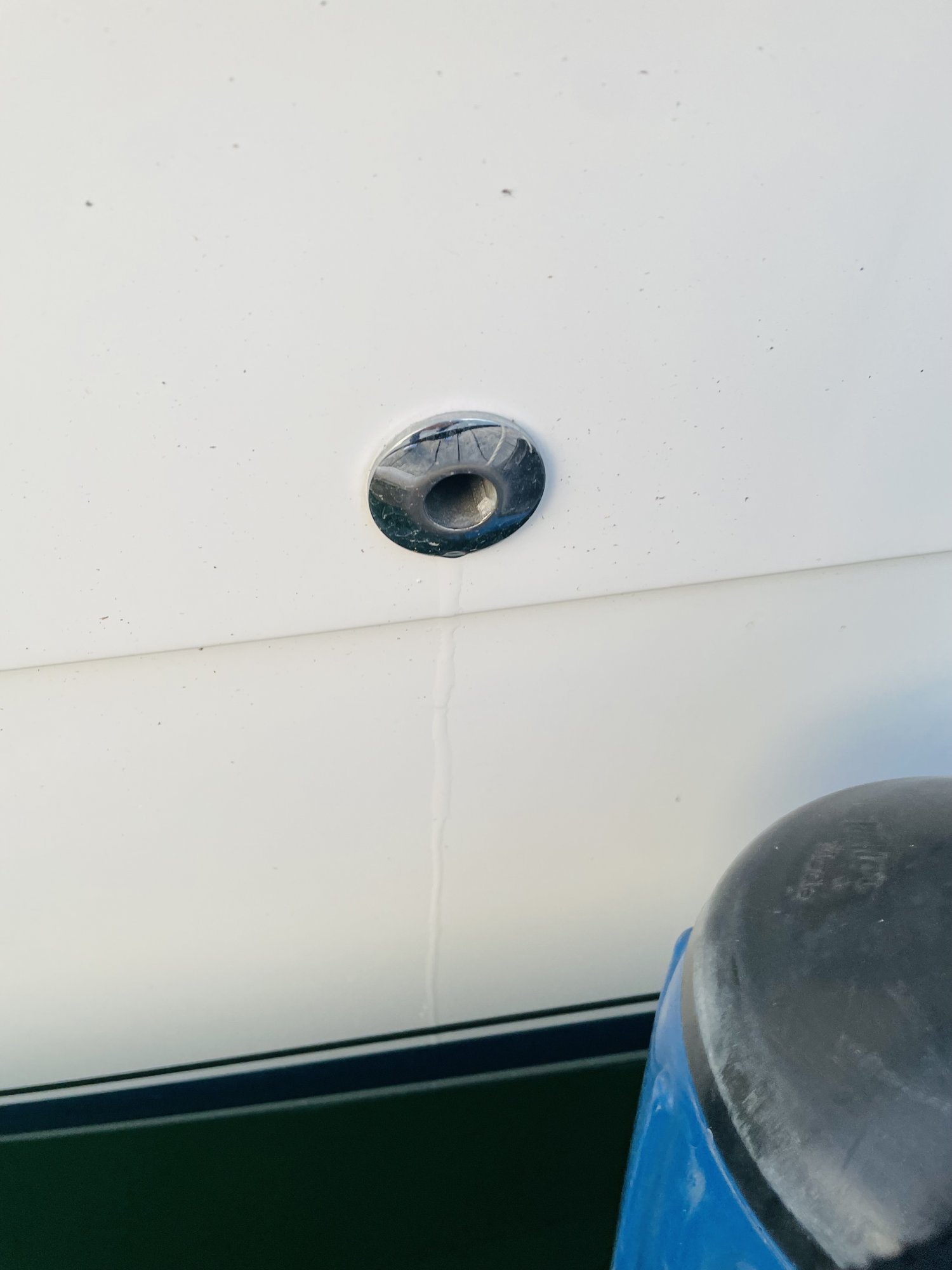

I also have a switch on the head to turn it on and off. I followed the lines. Here's what I've figured out so far:
The filter is open and unclogged. Water passes through it fine.
The thru-hull access is in the locker in the aft-birth, and water flows out of it (albeit slowly):
When the switch at the head is turned off, water flows back through the pump and eventually back through the drain. I feel like the pump should have a one-way valve of some type like a joker valve.
