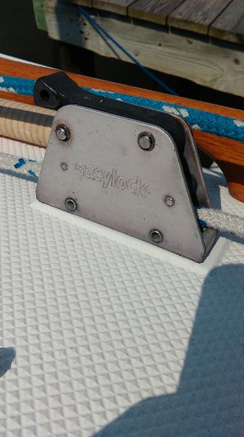

Just spoke with Catalina Direct about my 1986 Catalina 27, they told me that under the flat area where my clutch is there is an embedded plate that I can drill and tap to replace the starboard single with a dual clutch. Will try to attach a picture of the flat spot.

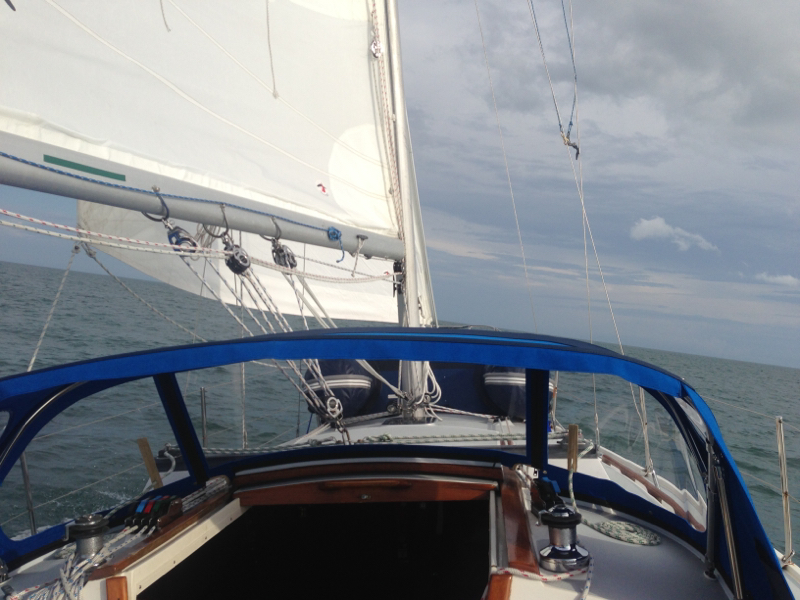

I have the same boat, same year (1996 Catalina 28). My rope clutches are all lined up on shiny (no non-skid) raised areas either side of the companionway.
The port side has four rope clutches, which pretty well fill the raised area. The starboard side has three clutches and a clam cleat for the mainsheet.
I use all the starboard clutches (main halyard, topping lift, and occasional use of clam cleat for mainsheet). Of the four on the port side, I only use three (assigned to the genoa halyard, reefing line, and a spare halyard).

I have 4 clutches on port and 1 clam cleat with 2 clutches on starboard. I have room for 2 more clutches between cleat and the 2 clutches to fit my out haul and second reef not installed yet .

Installed the double clutch on the starboard side where a single was, found a plate to tap into as expected, install was easy. Happy with the results. Hope you're install is as easy.
