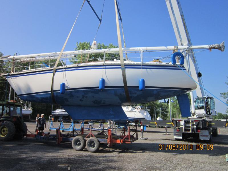

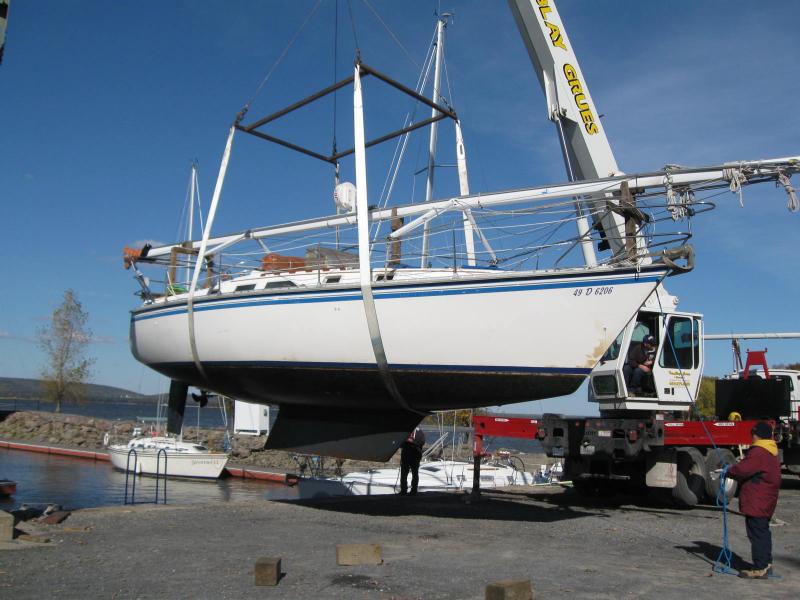

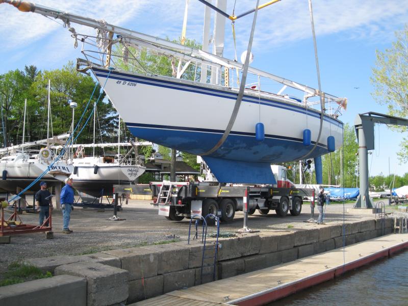

Dec 14, 2003
1,442
Hi Joe, sorry I didn't see your post sooner. Don and Seadaddler are indeed right on. In front of keel is no problem but your speed and depth might be there. So make sure the paddle wheel is removed. As for the back sling, it is critical to make sure that it does not ride on the shaft (easy to do). So after haul-out, Dan's advice is sound. Here are a few pics of my boat. My own haul-out is coming up on the 17. Hope yours went well. Claude
