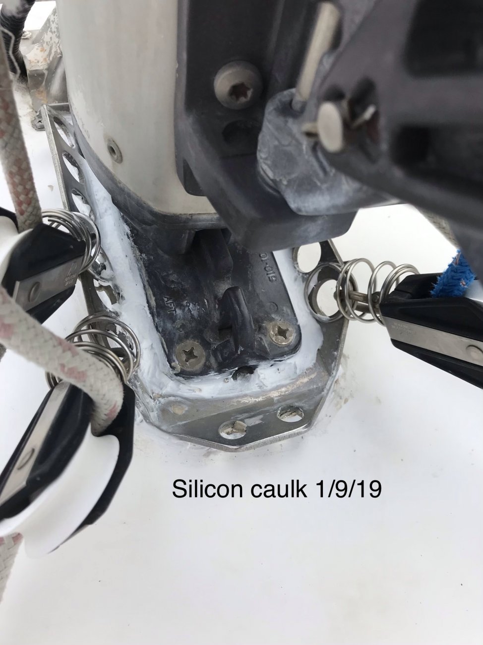

caulked the mast step plate with silicone as temporary fix.
Never use Silicone caulk around our boat; nasty stuff. Does your step plate have a weep hole for the rain water inside the mast to exit? Hopefully, you did not plug it with caulk.

Thanks for the heads up on the Silicone caulk. But that’s all I had at the time.
Not sure about the weep hole you mentioned. If it is there it is not visible. The only visible “drain” is the channel from the back of the plate to the front of the plate which I’d made sure that it was not plugged.
My standing rig is due for replacement and I plan to unstep the mast and re bed/seal the plate. What would you recommend to use?
Thanks.
Dec 25, 2000
5,942
My yard guys advised they always use 3M-5200 below the waterline and 3M-4200 above when doing boat repairs and that is what I use. Others will chime in here, I'm sure, with their recommendations.

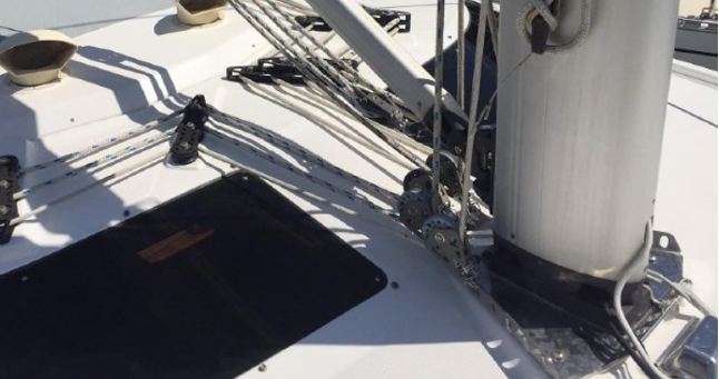

When I purchased my 2004 Hunter 386 it had the a similar issue. I traced it to the stainless steel cover just forward of the mast (see lower right corner of the photo). Once I plugged both sides the problem went away. I then removed the rust stains from the post in the cabin with a commercial rust remover fluid.
