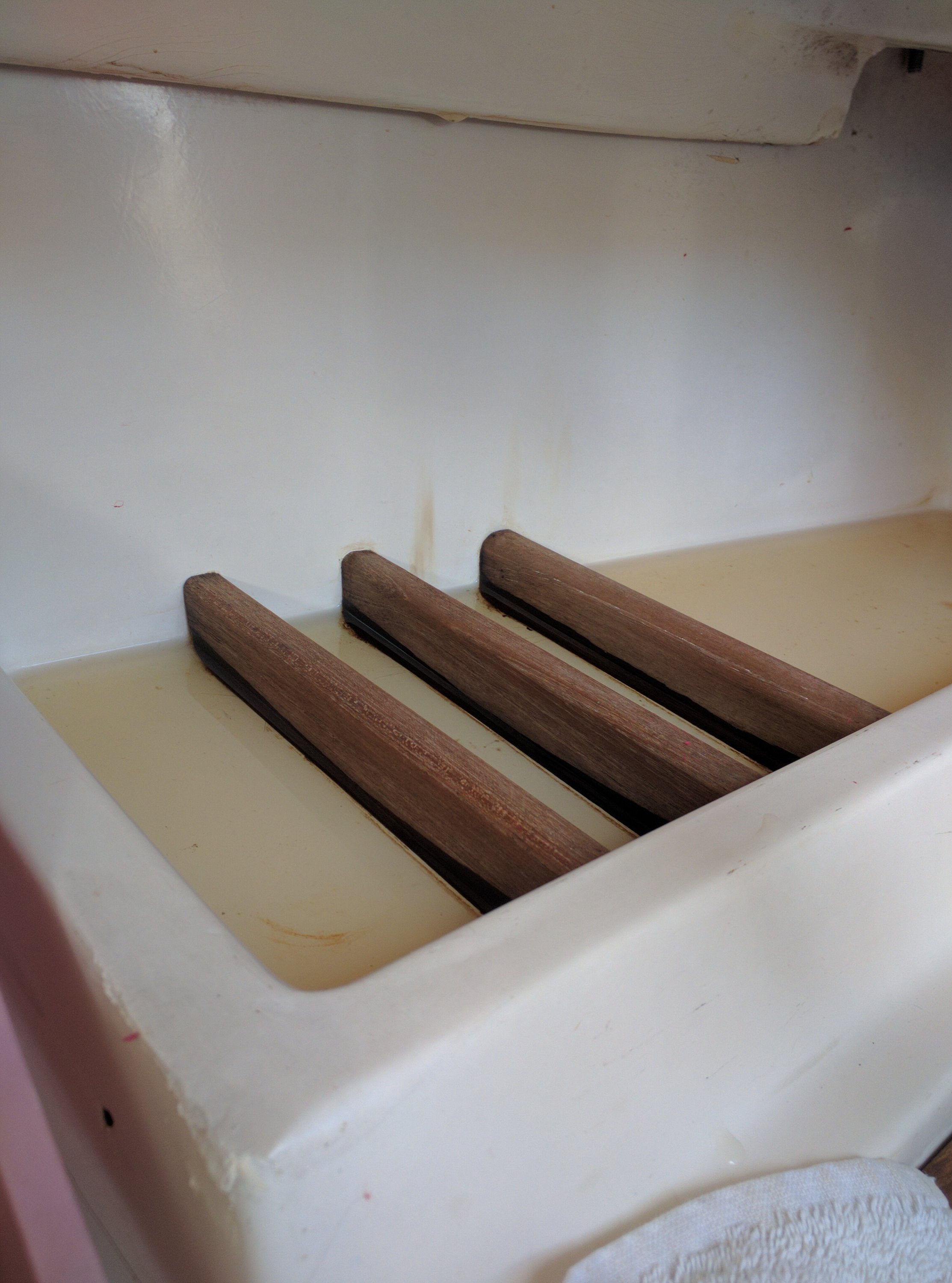

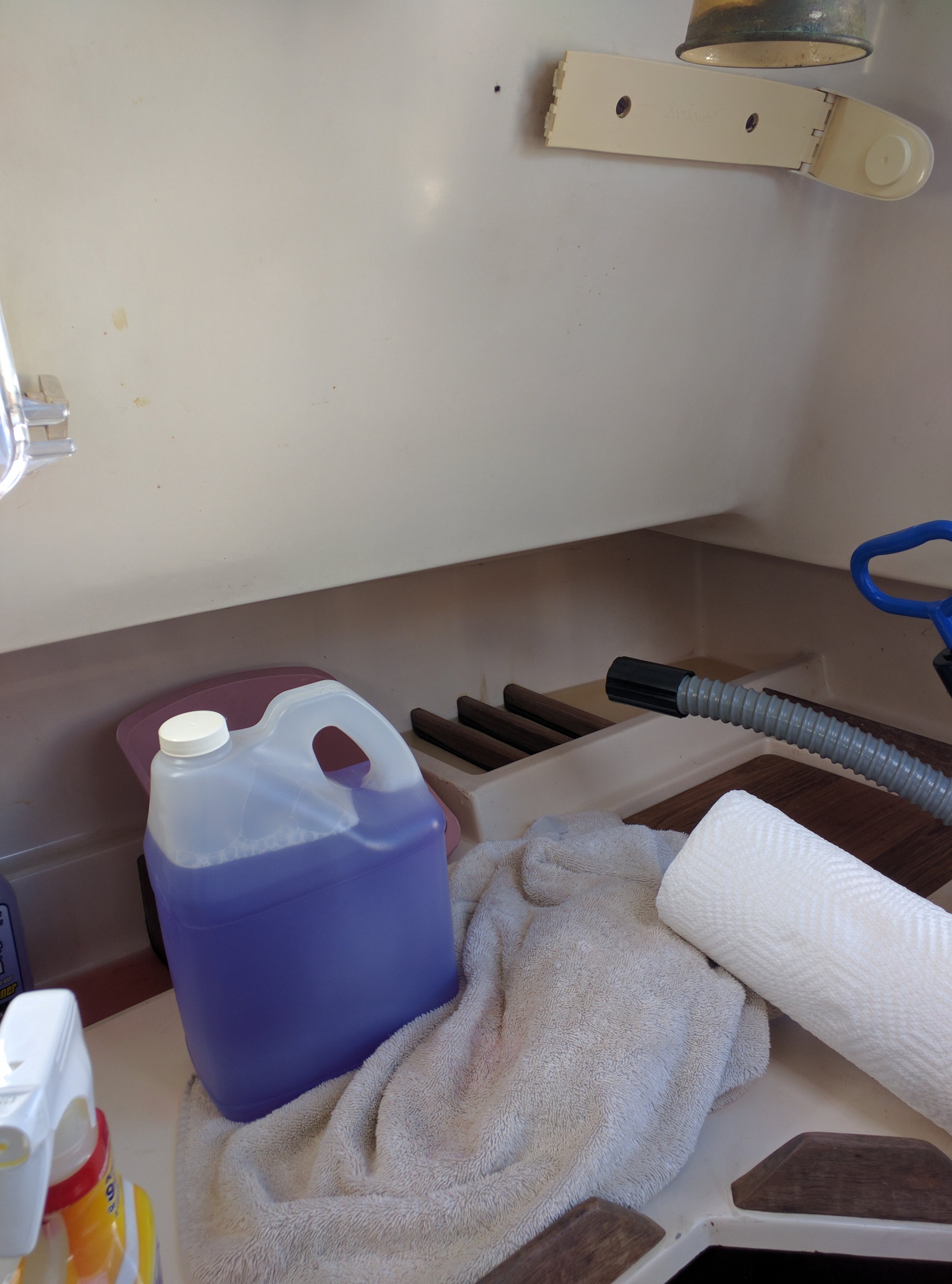

Hi,
Was hoping someone had the same problem and fixed it. I had multiple leaks on my "new" 81 hunter and I fixed most of them by replacing ports and sealing some of port openings. There is one persistent leak in the corner next to the sink and I have no idea where the water coming from. It's a slow leak. There is no port openings above the area. The only way for me to see it is to cut out the interior fiberglass which I'd rather not do. You can see it's all the way in the corner in the little recessed area with wood slats. The water just sits there. Also, is it normal to have about 1 inch of water in the bilge? I cleaned it out and it takes about a week to get a inch of water in it.

I had a minor leak in that area for years. Turned out it was coming in under the wood trim piece at the starboard end of the cabintop traveler and older bolt holes there from previous hardware. I originally thought it was from the portlite above the galley just forward of that area. It could also be from the screws holding down the companionway sea hood, cabintop winches or other hardware in that area.

Yes, I'm working on finding similar leaks also, what makes it hard is that the headliner and the cabin roof are two separate pieces of fiberglass with a 1-2" gap in between them (that's why you can't see the mounting plates for the winch and clutches, etc. from the underside in the cabin) That water could then be coming from anything mounted on the cabin roof on that side - blocks, wood trim, cam cleats, etc.
Two options are to do a site search on finding leaks with bubbles, chalk, etc. and see if you can pinpoint the specific one, or just go through and re-bed everything until the leak stops. I've done the stand up block and cam cleat for the mainsheet and one of those may have fixed it, keeping my fingers crossed. Read about bedding hardware and take your time and do it right.
The one I haven't found is under the galley sink, if you pull out the bottom drawer and stick you fingers down in, I have water that collects right there. The only place water can get into that space is the hull joint and port-side aft cleats, fuel fill, bimini brackets, etc. Good luck with it.
