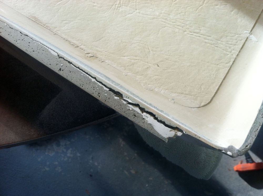

Sliding hatch "lips" cracking

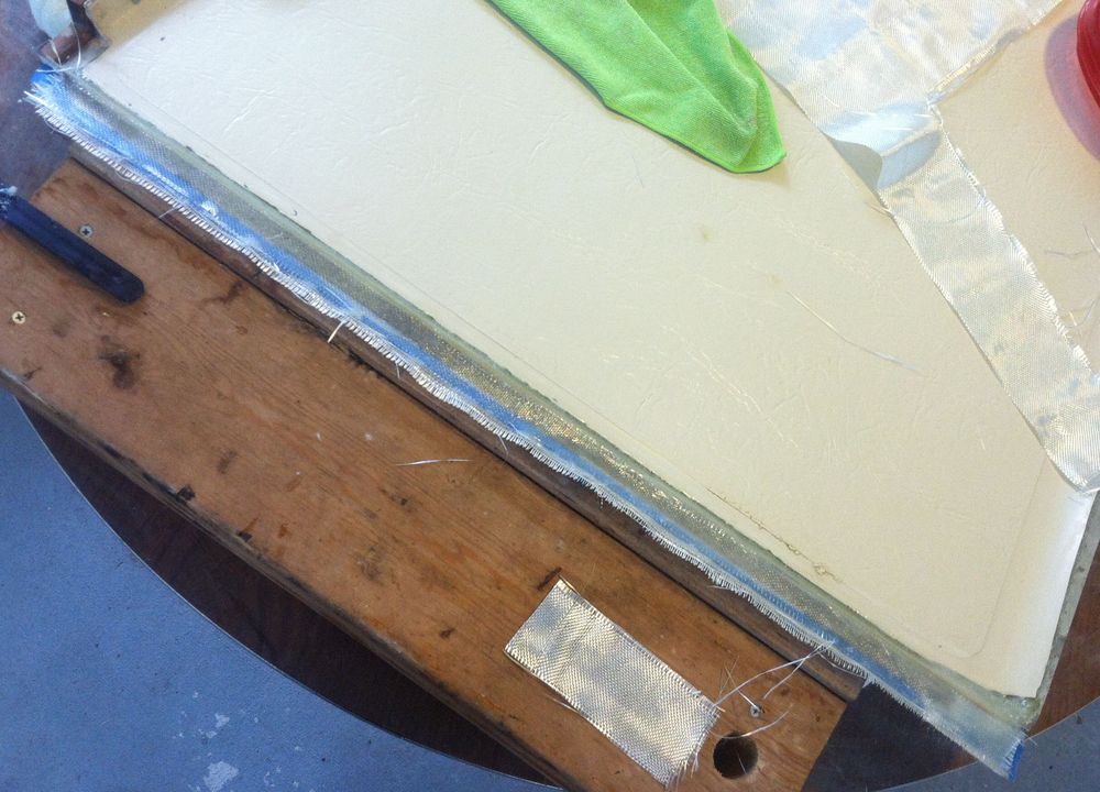

My gelcoat and Preval sprayers arrived! :D
It's a good thing I ordered two sprayers for the one job, because for some reason the first batch kicked a lot quicker than I expected, before I was done spraying. I mixed up a second batch real quick and drove on. I think it came out pretty well, except for a couple spots where I went too heavy. I guess I can sand them down easy enough, if they're noticeable?
Because of where this repair was, I didn't bother trying to tint the new gelcoat to match the old. I figured even if it was three shades off, it wouldn't look "wrong" just going down the sides of the hatch. But, as luck would have it, the color was very close to a spot-on match right out of the can!

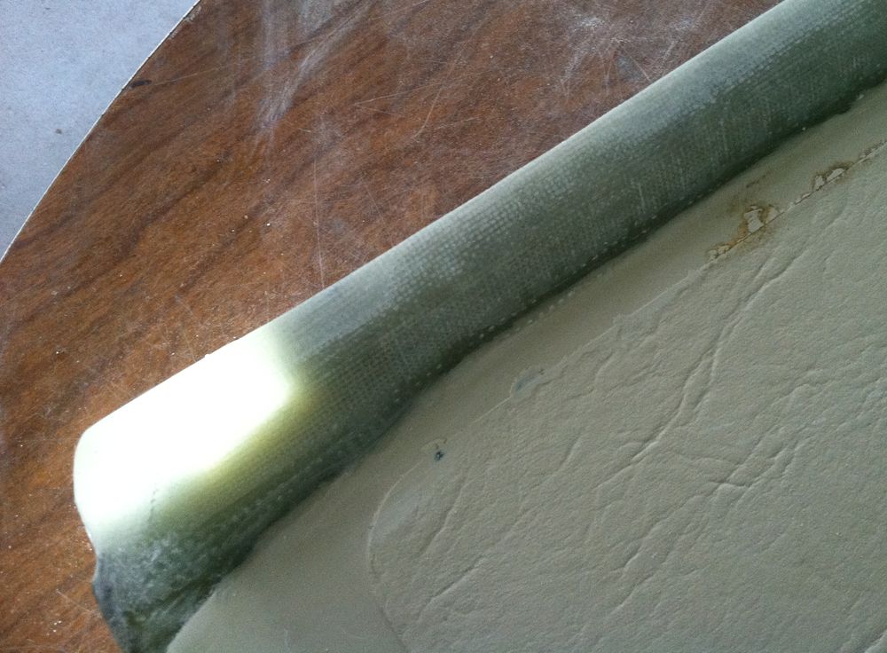

I'm leaving the underside as is. Since it's invisible from inside or out, I can't find a reason to spend any time on it when I could be sailing! It'll stay like this, except that I sanded it smooth where it contacts the rail:

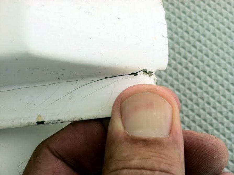

After researching the approaches both you and Stingy Sailor took, and considering the dire state of my sliding hatch, I’m going to embark on the repair you did here in the next couple of weeks. We just bought our first boat (a 1994 Cat22) last week, and this will be our first repair - and definitely my first time ever working with epoxy/fiberglass. After reading this thread numerous times, and watching dozens of how-to-fiberglass videos, I think I have the gist... but I have one lingering question... In one of the last pics of your project you posted it looks like you left blue tape on under the gel coat? Is that accurate? If so, why? Was it part of building the form for laying the initial layer of glass?

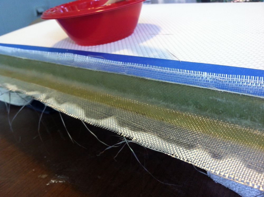

The tape isn't actually under the gelcoat. I just used it BESIDE the gelcoat, to make a clean edge. Ignore whatever pic that is. :) This was my own first fiberglass project as well. It's a good learner job. You'll do fine!

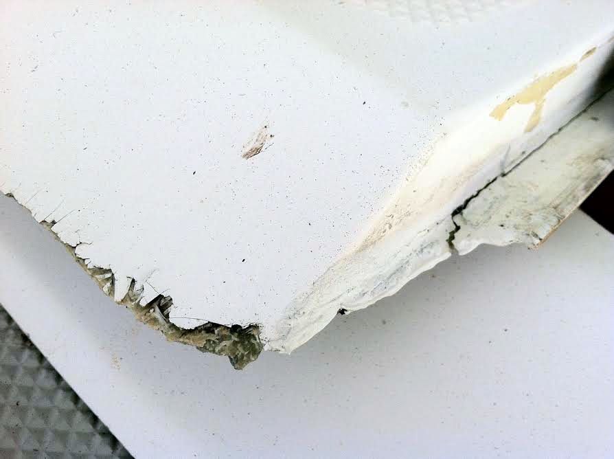

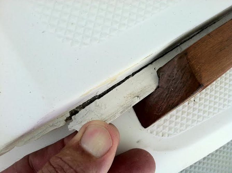

Thank you Gene and John for the welcome and encouragement! I’ve poked around this forum quite a bit and it is clearly a great group of friendly folks, and an awesome resource for a total newbie! I just had my first day with the boat, and the hatch came off quite easily without the need to remove either of the rails because the starboard side of the hatch lip is fairly non-existent. I’ll obviously need to remove one of the rails once I build the lips back up to install it. Hopefully they aren’t glued on, and they look to be in good shape, although it looks like it would be worth sanding the rails where they meet the hatch as I saw a lot of bumps inside the teak track.
Here are the initial pics of the hatch removed, upside down. The port lip looks better than it actually is, as there’s about a foot of it that’s just going to crack off, so it’ll be very little original lip to work with on either side.

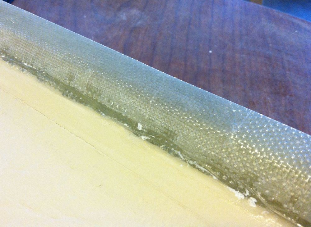

Update: Ok is good enough... I hope!
It didn't come out nearly as slick looking as Gene's, but I think is should be fairly functional. It was the first time I've done anything remotely like this, and I'm pleased with how it came out overall. I'm very messy and the wood needs to be cleaned up a bit.
Things I learned:
I cut the strips of fiberglass too narrow. I realized this after looking at Gene's pictures closer. It made it a lot harder and likely reduced the strength of the lips. I did make them pretty thick height wise, so it should last a couple of years I hope, but if I have to do it again I'll use much wider strips of fiberglass.
I used a filler product (pictured) to make up for some of my cosmetic errors and also to round out the corners so the fiberglass would hold better.
When I went to reinstall the hatch it didn't fit towards the front (bow), despite all my measuring. I started to sand a lot... but then took a closer look at the rails. They were on cockeyed, and I realized that a previous owner must have made the same *error* as there were a couple sets of screw holes. I used the other holes and the rails widened enough to have a great fit... thankfully, before I went too crazy on the sanding.
I have zero clue how the paint sprayers work. I thinned the gel coat as directed on the can, and followed the directions, but didn't get them to work. I'm a moron! - I used a paint brush and I'm content with the less aesthetic result.
