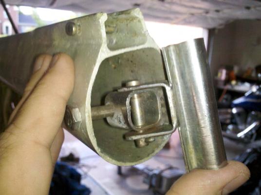

I have a question about a sliding gooseneck. Shouldn't there be some sort of stop to keep it from sliding down the mast? I've only delt with fixed goosenecks and something just doesn't seem right with this setup. Am I missing parts or do I just need to forget about the fixed style and embrace the slide.
Thanks in advance.

the bottom of your sliding gooseneck should have a ring on it. this attachment point is pulled down to adjust tension on the luff of the mainsail. this tension opposes the main halyard.
I installed a sliding gooseneck on my 26d to raise the boom and allow clearance of the heads of crew in the cockpit. I removed 18 inches from the head of my mainsail, installed a batten to hold up the flathead. when bending on the main, i run the main all the way up the mast and tie off the halyard. i then tighten the line from the ring on the bottom of the sliding gooseneck to meet the conditions of the day.

Thanks oreana123. I understand what you're saying about a loop and how to use it. I attached a pic of mine. It doesn't look like its missing parts but what do I know. Let me know if you see something missing. Thanks again.

Hero- I have a ring welded to the bottom of my sliding gooseneck that allows a line to be fastened to adjust luff tension. Actually, a sliding gooseneck is BETTER than a cunningham, which I used previously. I use the same cleat to hold the luff tension on the slider, that I used on the cunningham, threading it up to the ring and down gives a 2 to 1 purchase.
