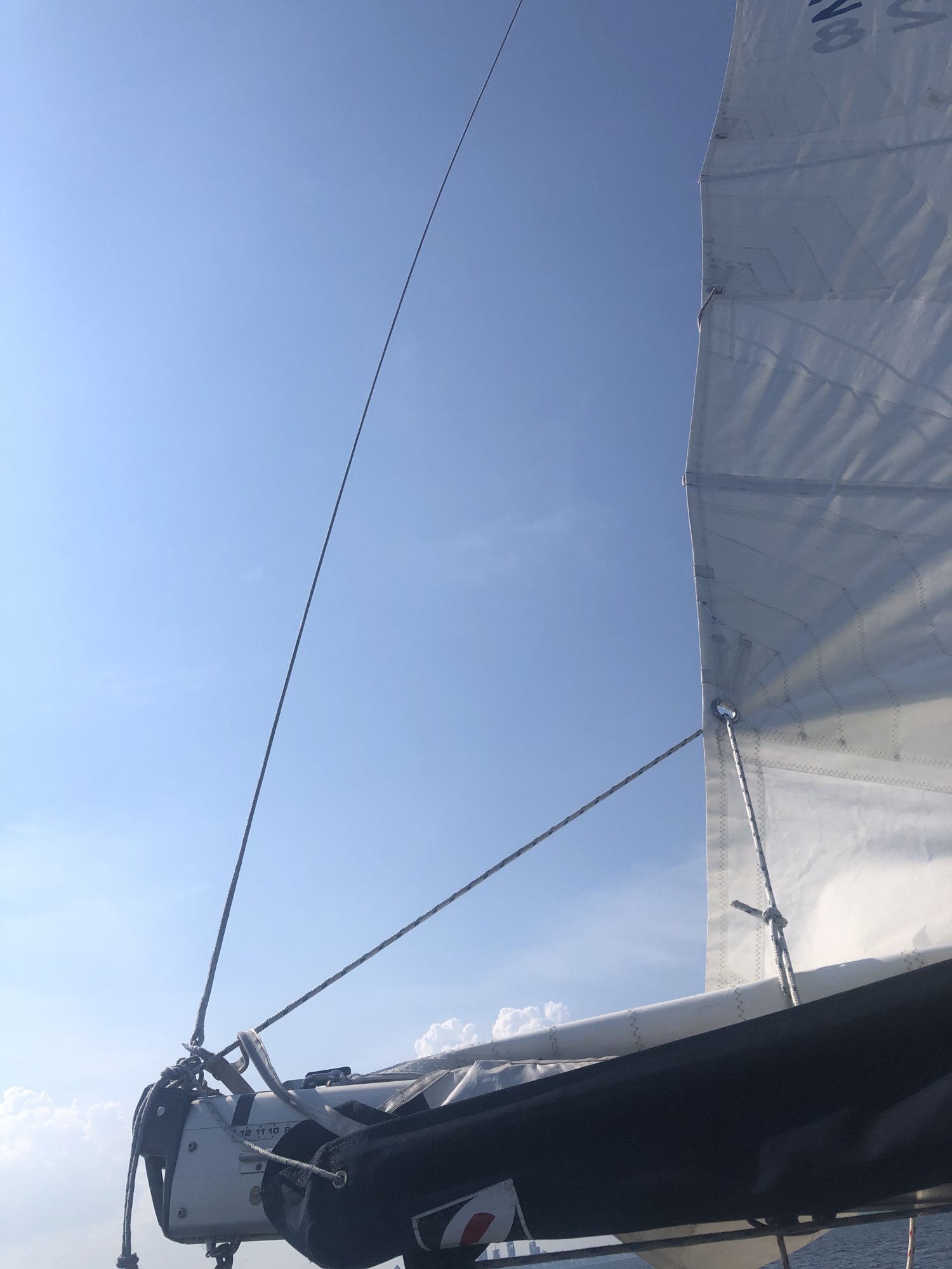

Pic of end result of hardened reef line.
Is that what it looks like reefed? That’s definitely not close to how it should look. But the way the reefing line is run should be able to get you in better shape than that. When you reef, be sure to:
-pull the luff down first
-have the mainsheet slack
-use the topping lift to pull the boom up, rather than trying to pull both the weight of the boom and the sail with the reef line
Also, have you checked that the reefing line runs smoothly and all sheeves are in good working order? Friction in them would make it harder to get enough force on the cringle.
Do you have a picture of the whole foot of the sail when it’s reefed?

@wyctoronto David has repeated the steps.
Your boom needs to move upwards to meet your sail reef. Also how is the stretch in the reef line. My reef lines are low stretch, like my halyards. Once tight they do not move. You will take all that slack out of the reef line and the new clew will sit on the boom or nearly so when you slacken the topping lift after the reef line is tied off.
