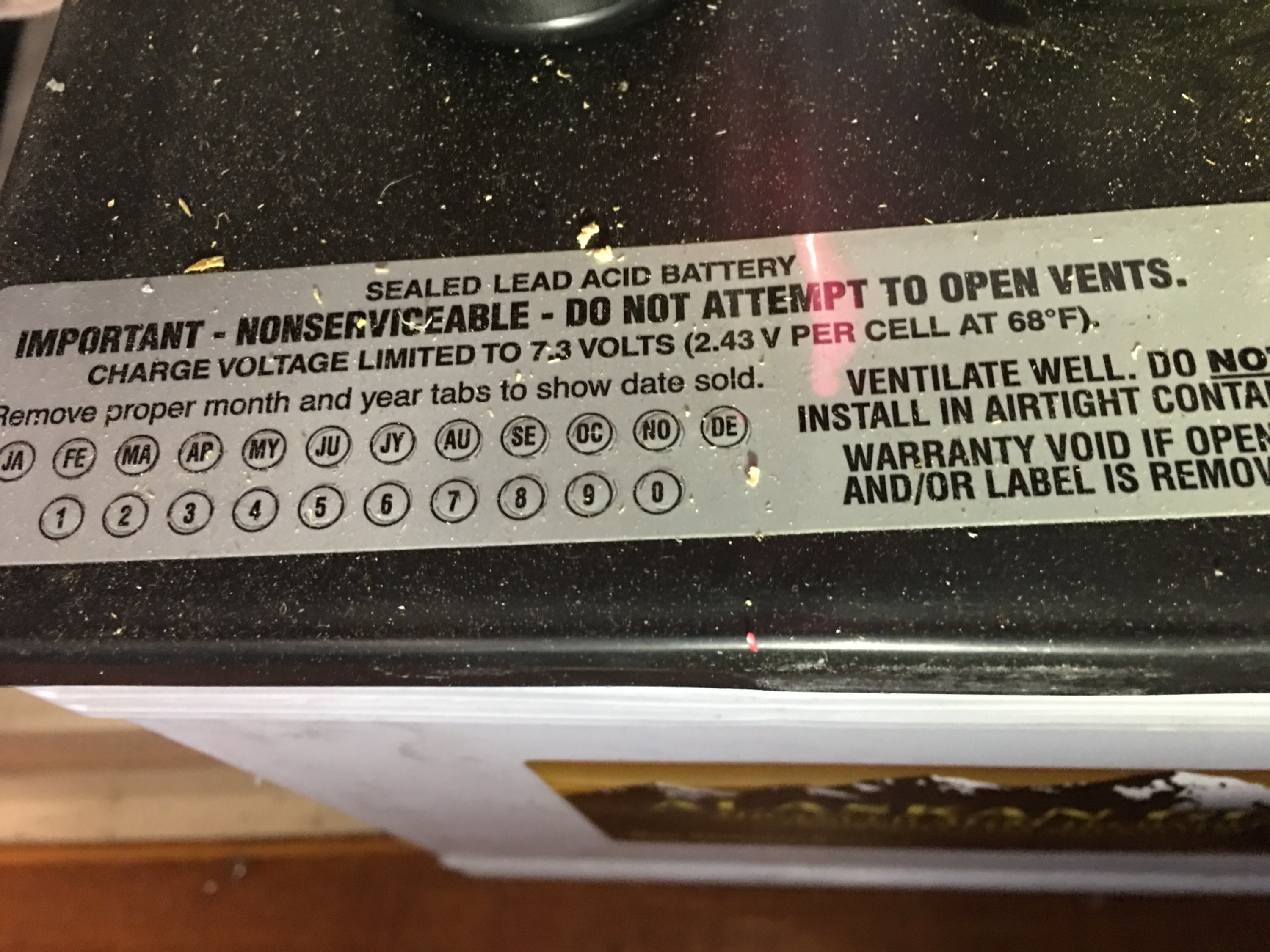

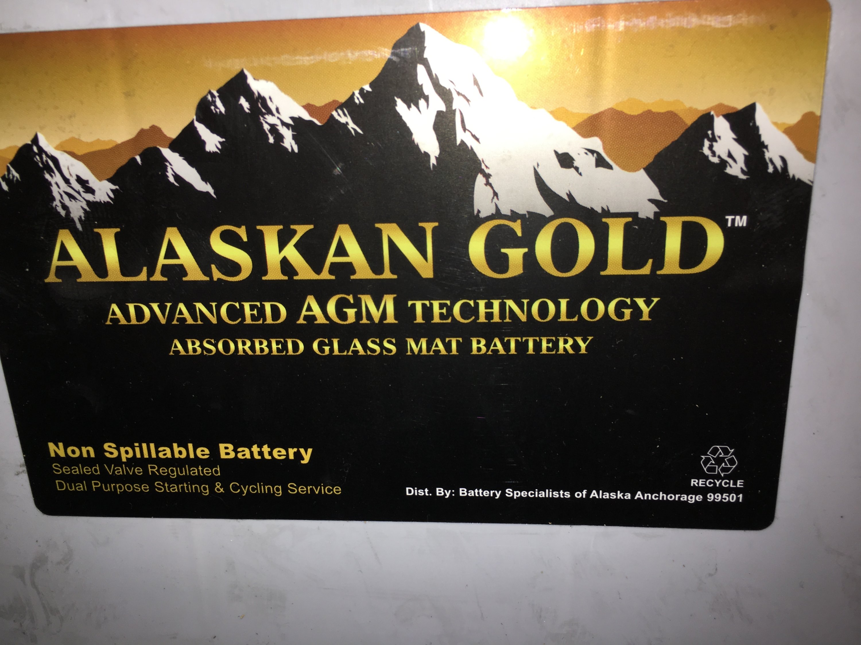

I was wrong. They are AGM - only thing that looked like a model is BAGC2. No amp-hrs listed
Charge limited to 7.3 or 14.6V. I will switch the balmer to AGM

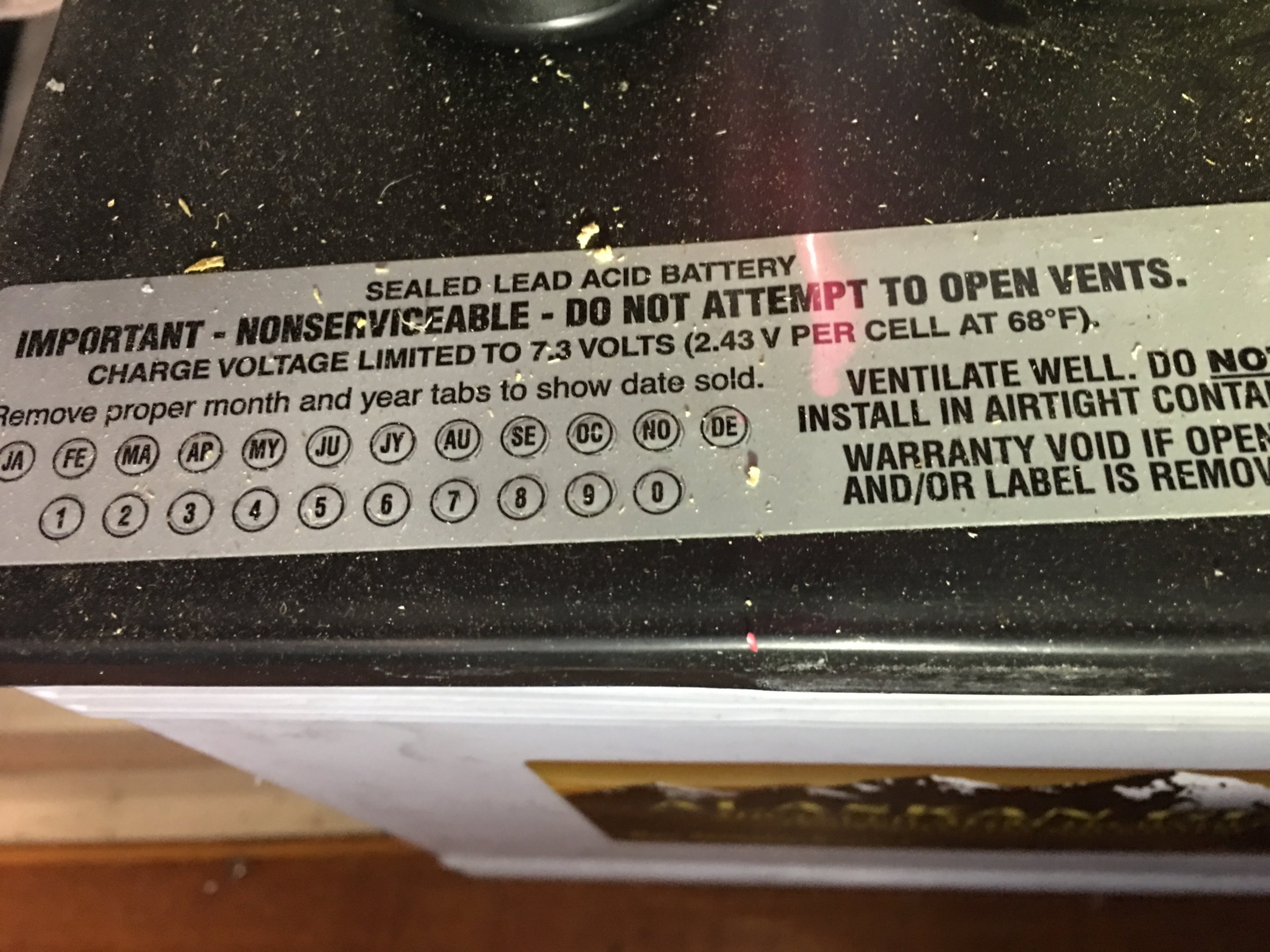

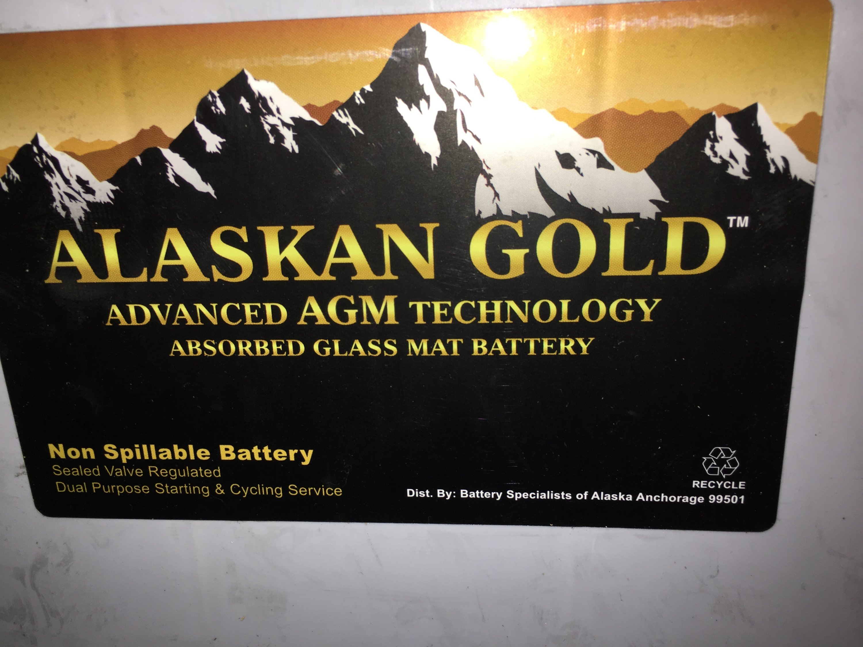

View attachment 134536 View attachment 134537
Without seeing a zoomed-out version of the battery its a bit tough to say for sure, but I am 99% sure those are a re-labeld East Penn / Deka 8AGC2.
These days I believe Whatcom is re-labeling the new Crown AGM's as "Alaskan Gold" but the Crown's are all black cases and Deka is gray with a black top. Also East Penn used to reference a 68F baseline for charge voltage temp compensation on their AGM and GEL series batteries, where everyone else uses 77F - 80F. Today they use 77F like everyone else.
I would not do that or you'll wind up under charging them in PSOC cyclic use. Like I mentioned in the article Installing a Battery Charger we really need to ignore the words "AGM, GEL or FLOODED" and focus on the voltages behind the words. The Balmar AGM setting is not optimal for East Penn AGM's. The closest factory programs in the Balmar would be FDC or OPS but again, neither are "optimal". For PSOC cycling (partial state of charge) you want the highest possible safe absorption voltage you can use.
The East Penn AGM's really need all the voltage they can get as they don't tolerate PSOC cycling as well as some others. See the May 2015 and August 2015 issues of Practical Sailor for more on this.
You'll want to configure the Balmar regulator using the advanced programming feature. Reduce bulk time/b1c to 6 min and set bulk voltage/bv at 14.7V. Now set absorption voltage/Av at 14.6V for a minimum absorption time/A1c of at least 1 hour. If you are off grid a lot then your A1c duration should be longer, upwards of 3-4 hours. Regulator float should be 13.6V and ideally, unless the batteries were already fully charged it should not drop to float unless you're doing a very long motor..
Undercharging East Penn AGM's in PSOC cycling applications is really bad for them. When you are tied to a dock set your new shore charger for 14.6V and 13.5V using the custom setting.
Can you equalize AGM batteries??
No, you can not condition/equalize East Penn AGM's with a charger that has an "equalize button". Only Lifeline AGM's can be equalized using a charger with an equalize button but it must be temp compensated and 15.5V limited.. The best you can do to condition them is to hold 14.6V to 14.7V for 8-10 hours to reduce sulfation.
