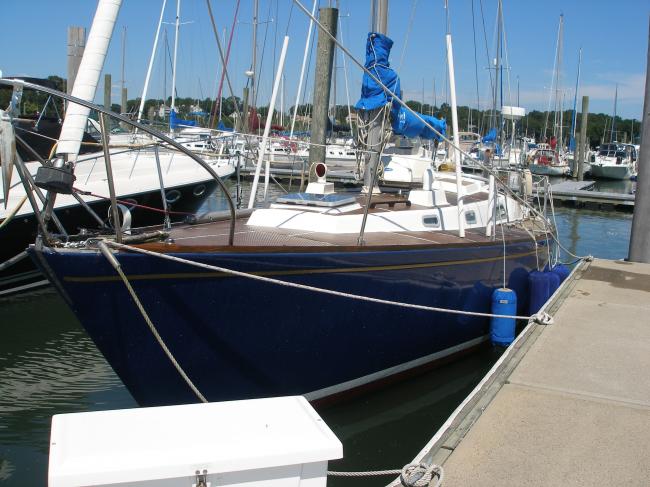

Sonny Boat looks great! Is that a teak deck?? Greg 1986 P36-2
S
Sonny
Deck
No it is a Tredmaster deck that I put on years ago. It sealed the deck with a non skid surface. I didn't want to go through the trouble of redoing the deck surface with jsut paint and sand. The orginal deck was a non skid pale blue color. Sonny
