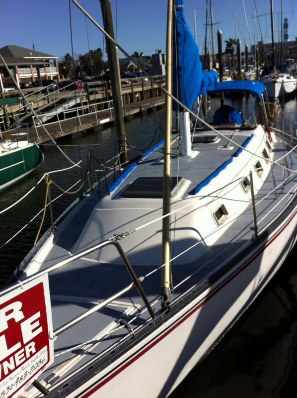

Photo of top side after using West marine Non Skid Paint.
One of my concerns is that my nonskid areas have a waffle pattern to them. I was hoping I could sort of hid those, more or less.
