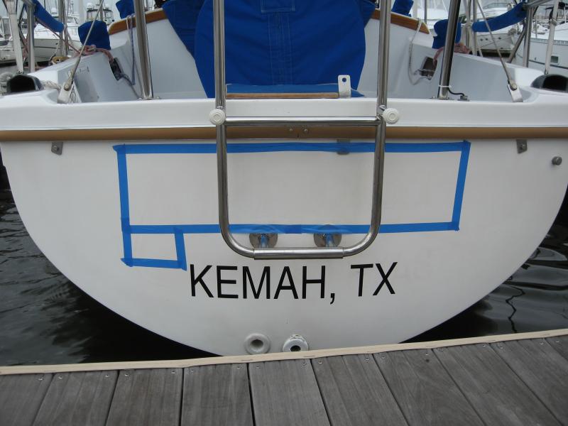

Don't know if this helps at all, but I used this when I was laying out the name on my transom, and I seem to remember that this box was about 11" x 32". The hailing port letters are 4" high.
DanM.
