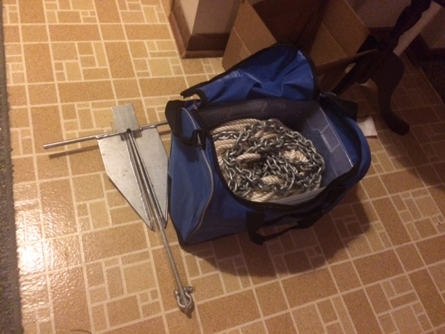

Sumner, got what you recommended. Picked up a perfect set-up at Walmart though the hard plastic liner was a separate item added but it fits perfectly. What do you recommend for cutting the holes int the bottom? I'm afraid whatever I do will end up ripping or coming apart. Should I burn the area where I put the holes in to melt the fabric? It looks like in your picture you're showing something that may have been used to put the holes in it but I can't say I've ever seen one of those before.
Showing 160' of 1/2" line and about 8' of chain in the bag.

...What do you recommend for cutting the holes int the bottom? .....
You can drill through the plastic insert and use a hollow punch to go through the fabric if you want...
http://www.harborfreight.com/9-piece-hollow-punch-set-3838.html
