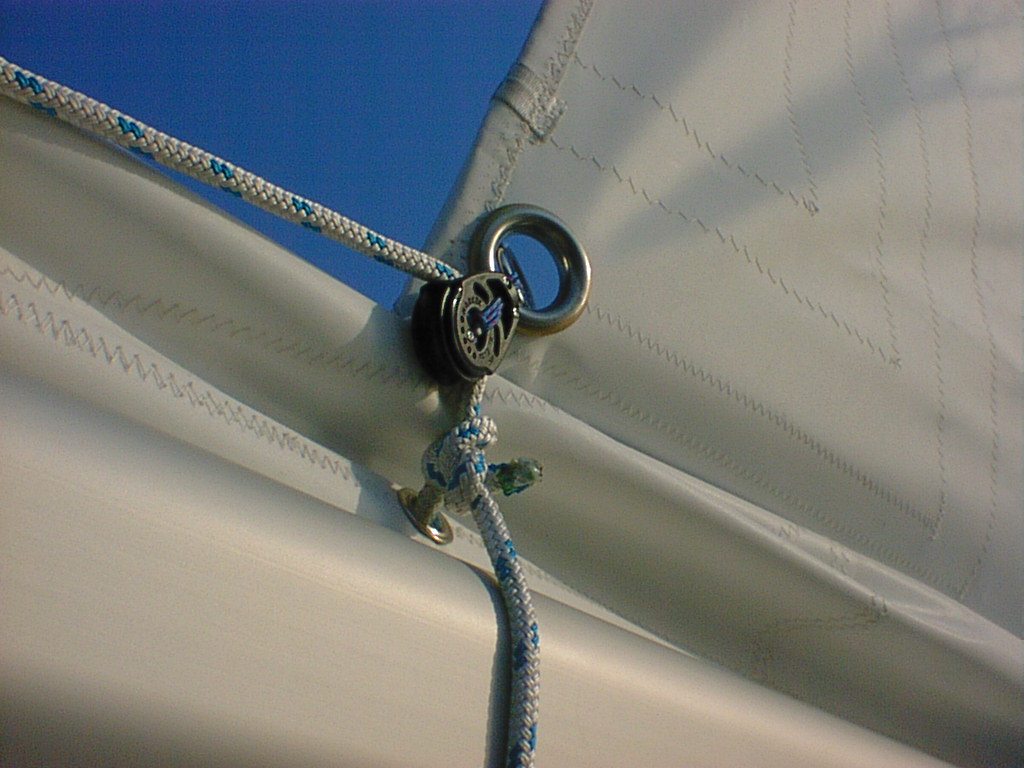

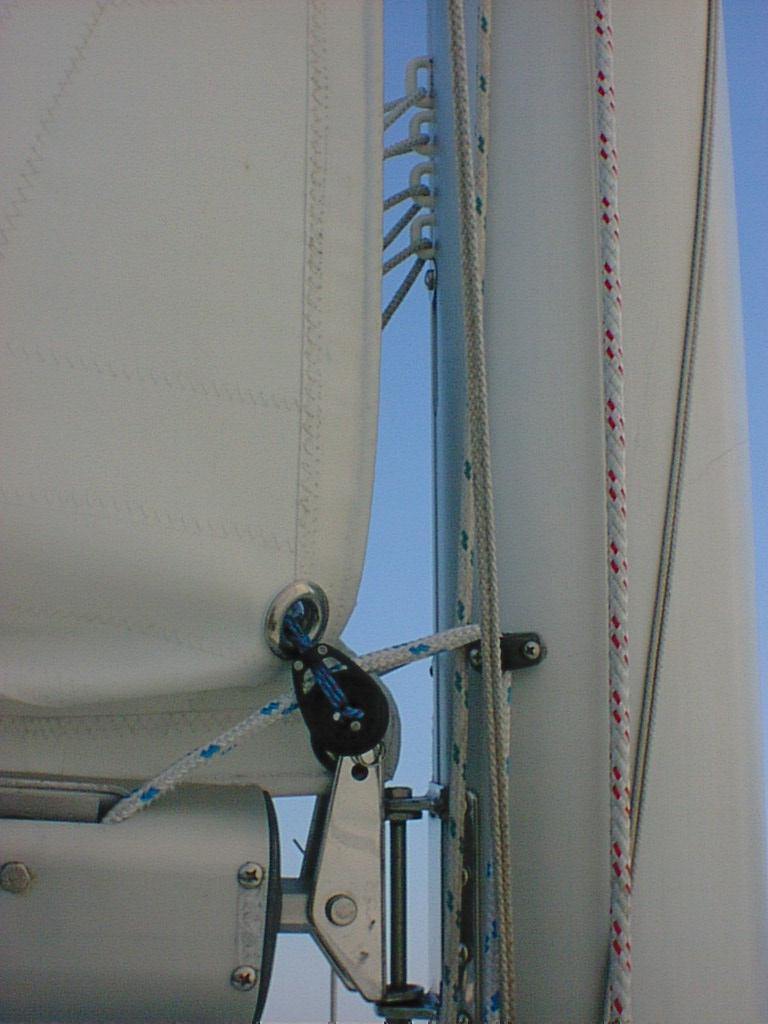

Matpearce: I'm not sure I totally understand your question - are you talking about the friction between the reefing line and the grommet in the sail? I installed small blocks at each grommet and reduced the friction and doubled the mechanical advantage.

Please supply more information on the blocks you have added. Size, attachment maybe a picture or two.

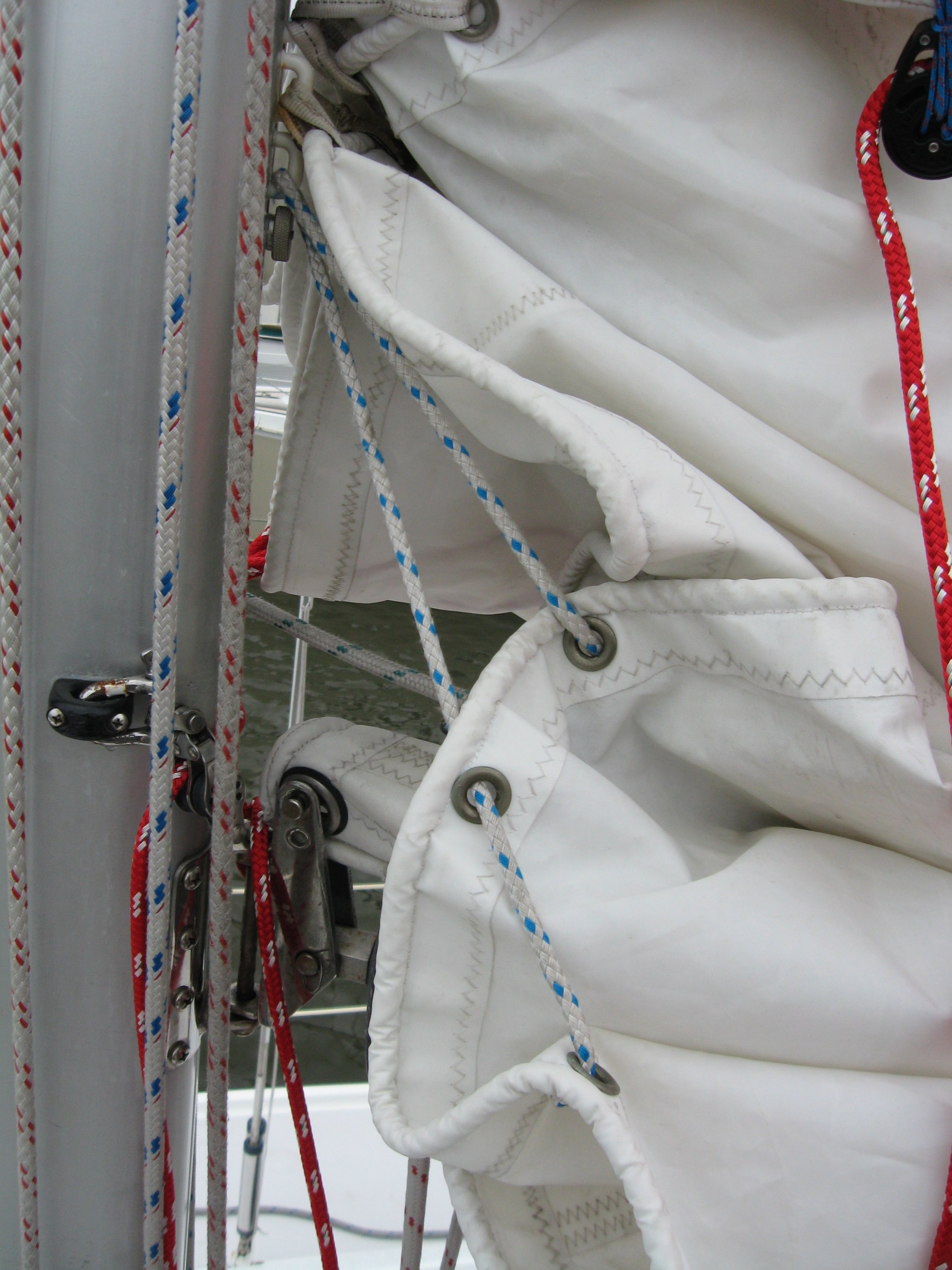

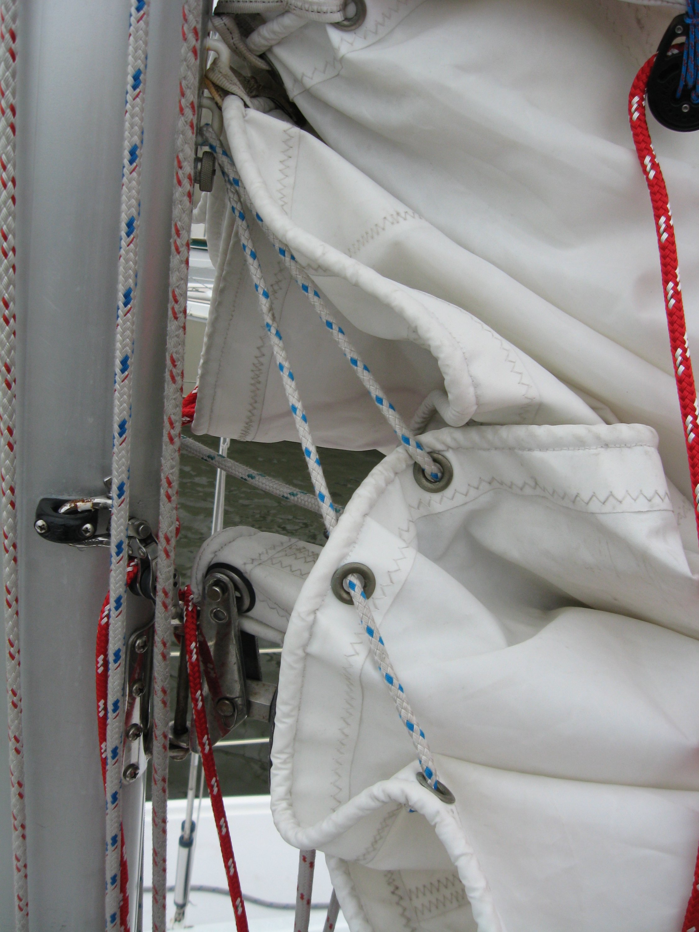

I installed a second reef, and have sheaves in both reefs. Here is a photo of the jumper to the slug discussed above. Without this you cannot reef without removing the slide stop, but I believe this was standard rigging on the original OEM main. Even with the blocks, I still need to leave the cockpit to put in the reef properly. Traditional slab reefing with two lines is just as easy in my opinion, but this is the way the boom was set up by the OEM, so i live with it.
