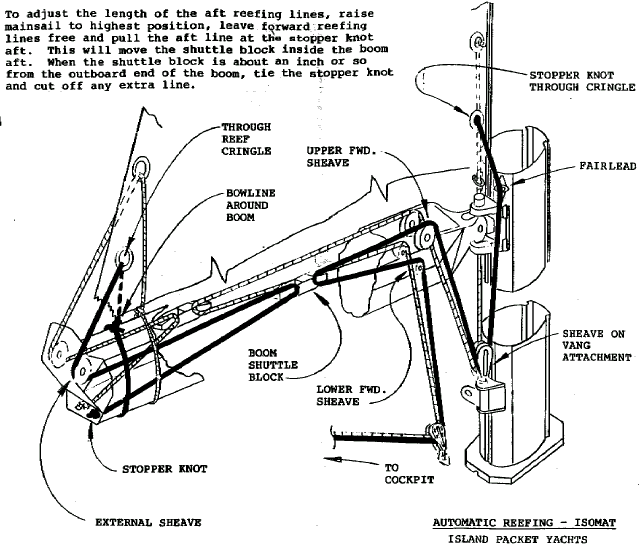

UPDATED, CORRECTED:
So, after another weekend on the boat, I can say that I don't have the Isomat AutoReef system, as illustrated in the two images, below. At least, I don't think I do.
I do, indeed, have two sheaves facing up at the outboard end of the boom (actually three, since there's one for the outhaul), and four facing down at the gooseneck; but I don't have the outboard endplate with the holes for the stopper knots, and there are no shuttle blocks present.
There actually is a small end plate with three holes in it. The holes are 3/8"
There is a ring at the top of the vang bracket to which I can attach a double block.
In addition, there are turning blocks attached to the mast collar, and one fairlead on each side of the mast, as in these drawings.
Any input on how to rig this?

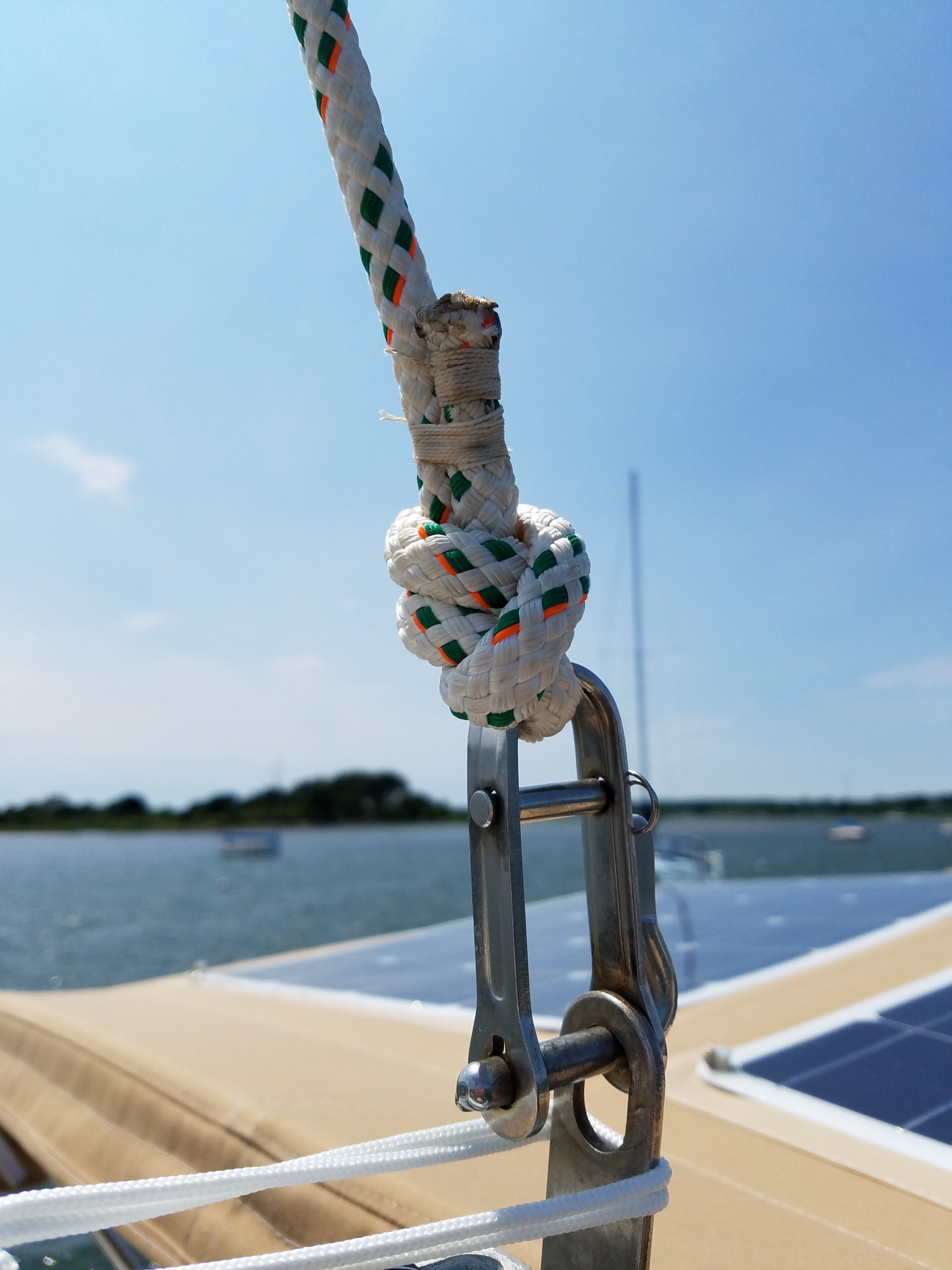

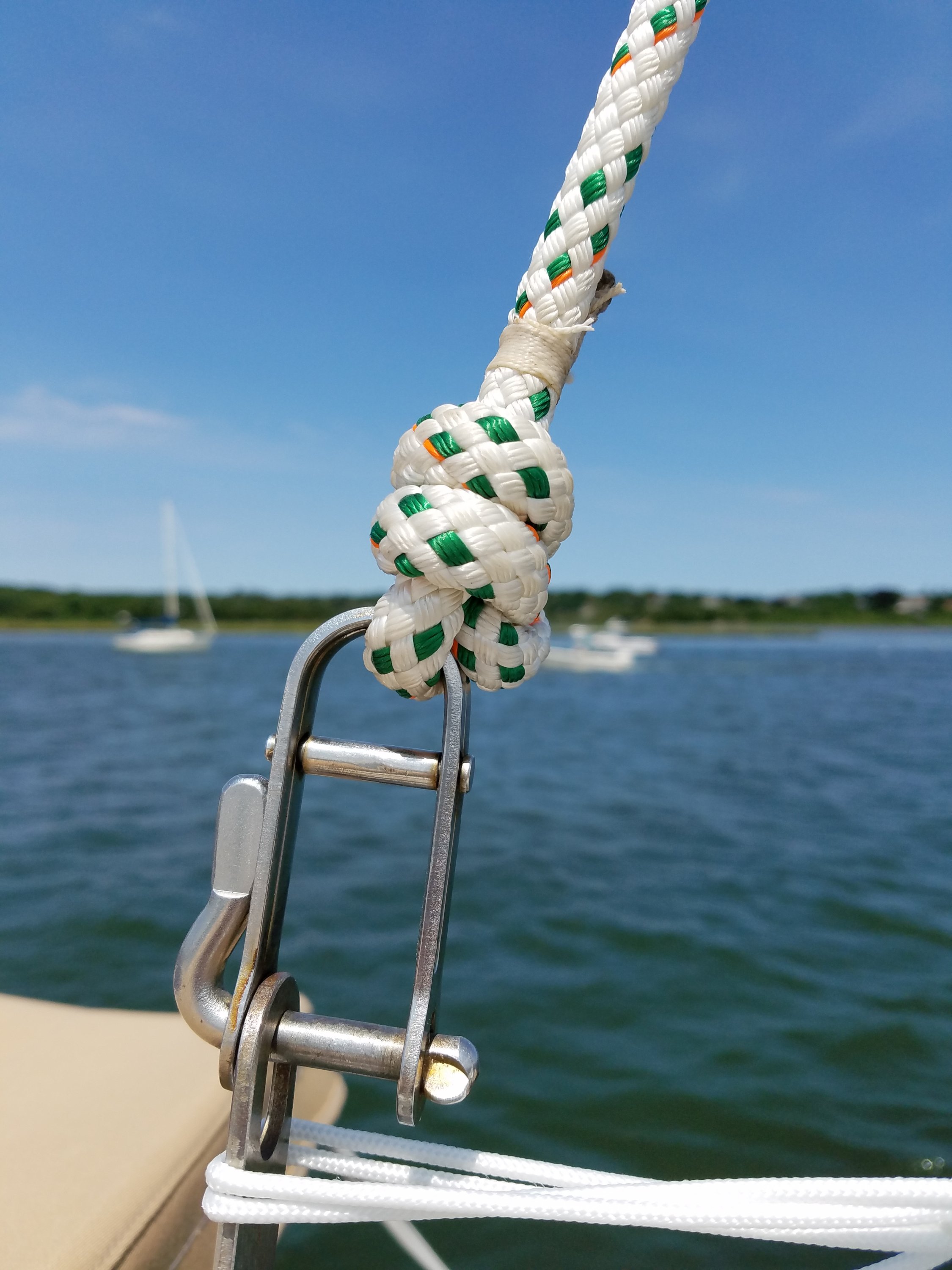

Thanks. I like VPC, put it on my C36 for halyards last year. It only comes in metric sizes, 6, 8, 10, 11, 12mm. Their catalog equates 3/8" with 10mm, and 5/16" with 8mm, but 3/8" is really 9.5mm, while 5/16" really is is 8mm. That's what I was thinking of using. The only issue is that I've found I had to sew the cover to the core before whipping. I have done eye splices in all kinds of line, but I prefer a hitch or knot now, as it makes end-for-ending easier. I might finish these with a Flemish eye for ease of pulling in/out for winter haul-out, leaving messengers in place in the boom. For the C36 halyard I used a seized halyard hitch onto the shackle.
