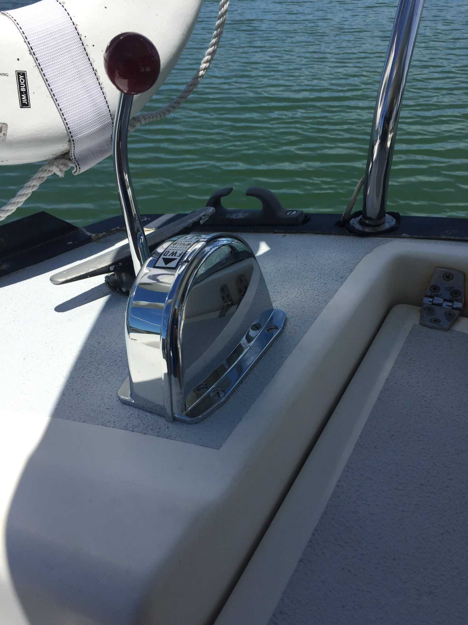

RoyS
Jun 3, 2012
1,742
Made the switch to single lever dual function controller from two lever pedestal mounted controller last year. Would never go back. Mounted the controller behind me at the helm. Easy to reach back with one hand. Great for single boat length spins in tight marina.
Jan 7, 2011
5,370
Oday 322 East Chicago, IN
How do you disengage the transmission with that unit?
Greg
