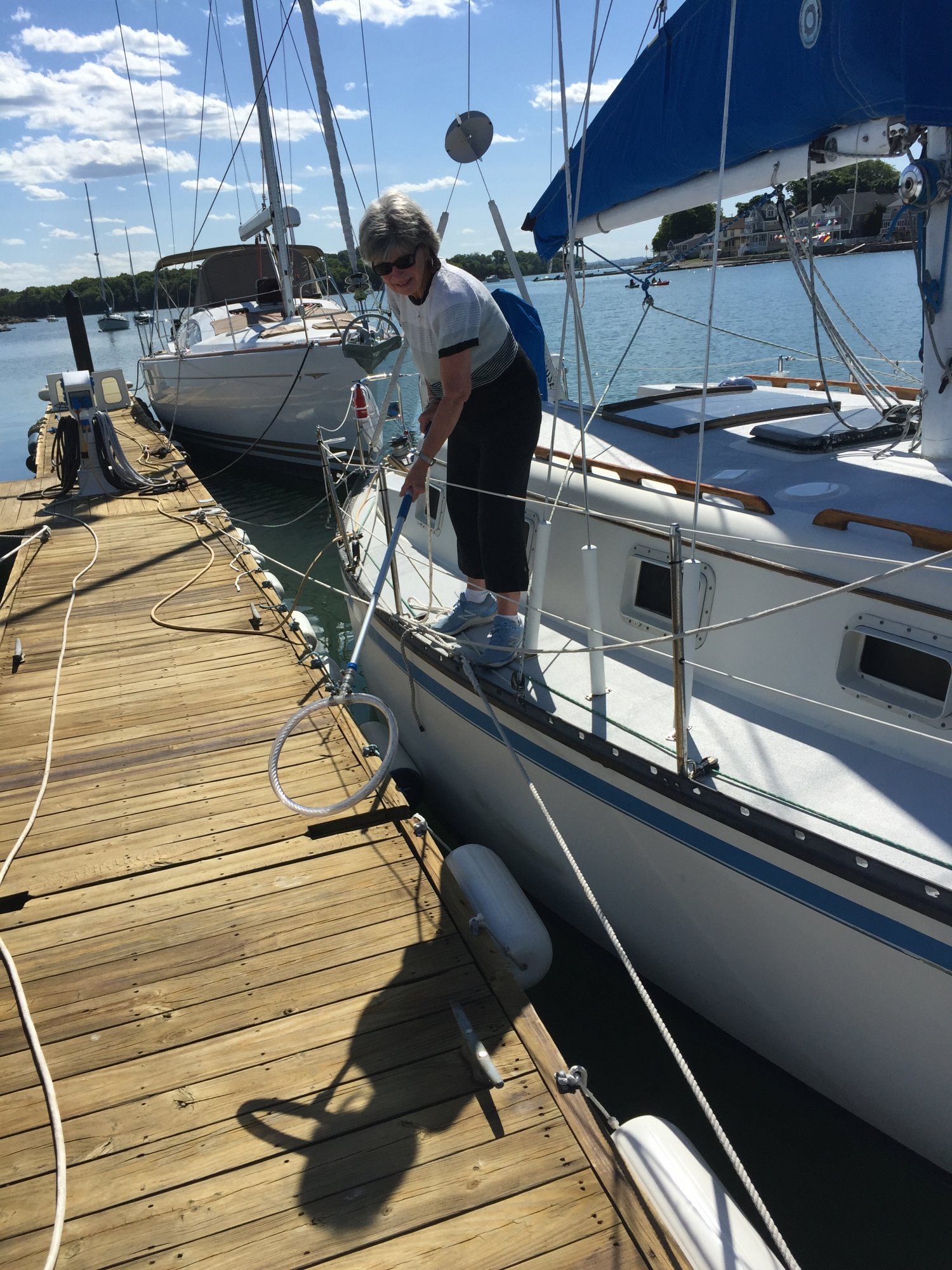

Wife shown here with our "No Jump Cleat Snagger." Attached to a pre-measured midship spring line it lays us tight against the dock while our engine remains in forward on idle. Wife refused to jump anymore. Necessity is the mother of Invention.

Interesting devise. Would a typical boat hook work as well? Or was a boat hook modified to produce this equipment?

Look up "docking stick". They come in pairs and are used with your boat hook pole. They work well for this. However, since we started using a stern bridle, we rarely even get them out anymore.

Giro, The snagger I made from an old boat hook. Removed hook and replaced with a T hose fitting. Spliced a three strand line into a loop held in a ring shape by clear pvc hose. Line passes through all three legs the T fitting and through the handle, exits at the end and has a pre-measured spliced loop on the far end of the line that attaches to our mid point cleat. Pole is expandable for reach and collapses for storage. PVC hose which envelops the line loop at the snagging end attaches to the T fitting with hose clamps. When we enter our slip, the line is already connected to our mid-point cleat. Wife reaches out and snags the cleat at the very end of our slip as we pass by. This is easy as the loop is held in a perfect flat circle by the hose. After snagging the cleat she holds it from slipping off until the boat has proceeded further into the slip and the spring line becomes taut. At this point the snagging loop has folded into a tight oval and cannot fall off. Then she lets go of the snagger and steps off onto the dock and retrieves the bow line that was draped on the lifelines. She connects that and walks aft along the dock and I hand her the stern line which she connects to the dock. In the meantime I simply hold the boat in place by idling in forward. No drama here. This works for any slip we may encounter as the spring line length places our stern even with the end of the slip where there is always a cleat. After we are secure we replace the snagger with an ordinary spring line and store the snagger for the next trip.

Some excellent docking procedures and something we don't see very often on the sail trim forum and that's a picture of a elegant young lady from Hull, Ma demonstrating a docking devise created by her husband.
