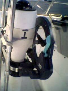

A couple of Cherubini owners had asked about mounting the Simrad autohelm. I took some pictures yesterday with my very cheap AOL camera. I'll post one here to see if it worth the effort to put them in the Photo Forum. There were basically two issues. One is the clearance between the WP30 clutch and the shift lever. I hope this picture shows that to be about one inch in the disengaged position, much more when engaged. The other was the mounting of the unit to the four-inch diameter post. I used one of those heavy rubber pipe couplers to get better grip. And it came with better hoseclamps than Simrad provided. So here goes. Oh well, it was worth a shot. Guess I should be spending the money on a camera instead of the boat. Nah.

I tried it
i took your advice about the plumbing thing and it made some difference but because it is made of rubber my autopilot has a tendency to occilate back and forth while sitting at the dock...seems that evey variation to the position of the boat causes a variation of the flux gate compass and it shakes the whole wheel/binical assy and that just causes it to get going more. seems that a more ridgid assy is necessary to keep the flexing of the rubber from causing shaking of the pedistal and causing varaitions to the compass on the autopilot.... what settings do you have the sensitivity, yaw and sea state set to ??? chet

and wondering. Mine does not do that Chet. I am wondering if you have the bands tight enough? I would have to check the manual to remember my settings, it has been three years since I touched them. But I know they are low, it does not "hunt" for example. Coming off a big direction changing wave or puff it might go thirty seconds before the correction. For two reasons, less battery use and less wear and tear.
