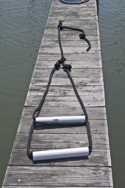

I had a similar issue.
We did not secure the dinghy well one evening and I ended up swimming out about 30 yards while we were at anchor to grab it. Realized that I really could not get into it so had to "tow" it back myself (dead calm, no wind).

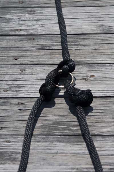

So I made my own ladder. About $20 at home depot. Works great. We just leave it in the dink and it is there when we need it. I'm about 6'0" and 179lbs and it holds me fine. Some PVC pipe, rope, and some rings. I can always grab the loose end with the knot to get the ladder out. Then use that to pull me up with the steps.
Glenn

I affirm the homemade device as described, I made two very similar devices over the past 20 years or so and the first was popular enough to have been borrowed by someone I did not know and have not gotten it back yet????? I have only had to replace the rope in my second one as the edges of the pipe wore through it until they rounded out.l
Nov 28, 2009
495
Catalina 30 St. Croix
I made a similar one as the PVC one except that i used a broom stick cut into four wrungs. Drilled holes at both ends and ran lines through them with over hand knots at both upper and lower of each one. Also the rope was long enough to reach opposite side to create a good hand hold. It's 12 years old now and I still use it.
