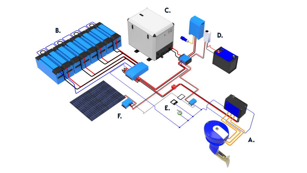

I have also been looking at this innovation by OceanVolt...
I guess if I had deeper pockets...:rolleyes:
I think that this the unit Sailing Uma just installed on their boat.
they have been working with a home-made electric system and a traditional shaft, but they just installed an electric sail drive.
Greg
Very Cool.... I'm interested in how it works out for them. Someday... if I ever buy a bigger boat and have to repower... I'll definitely consider this route.
