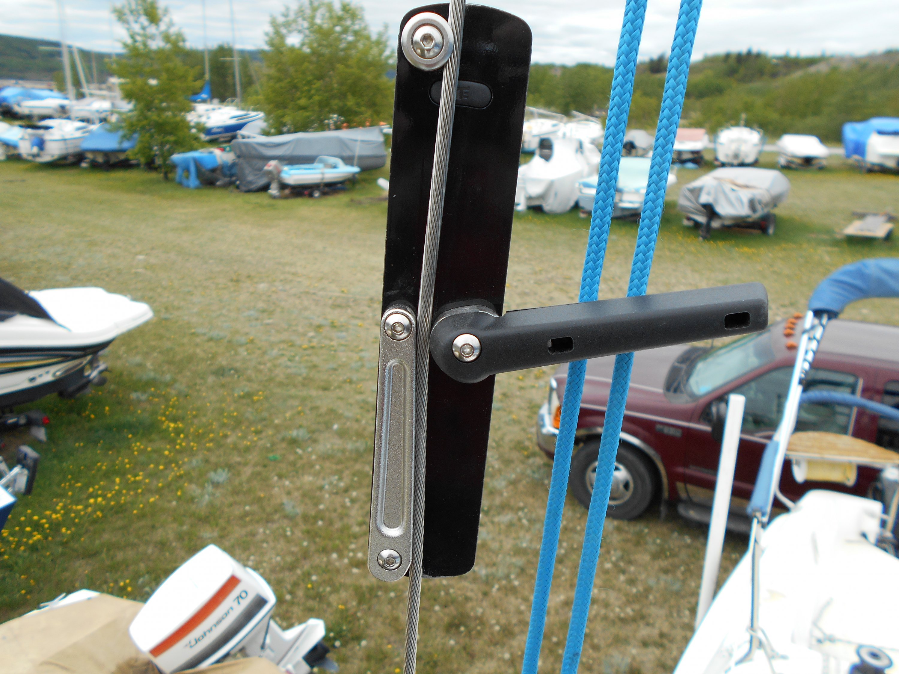

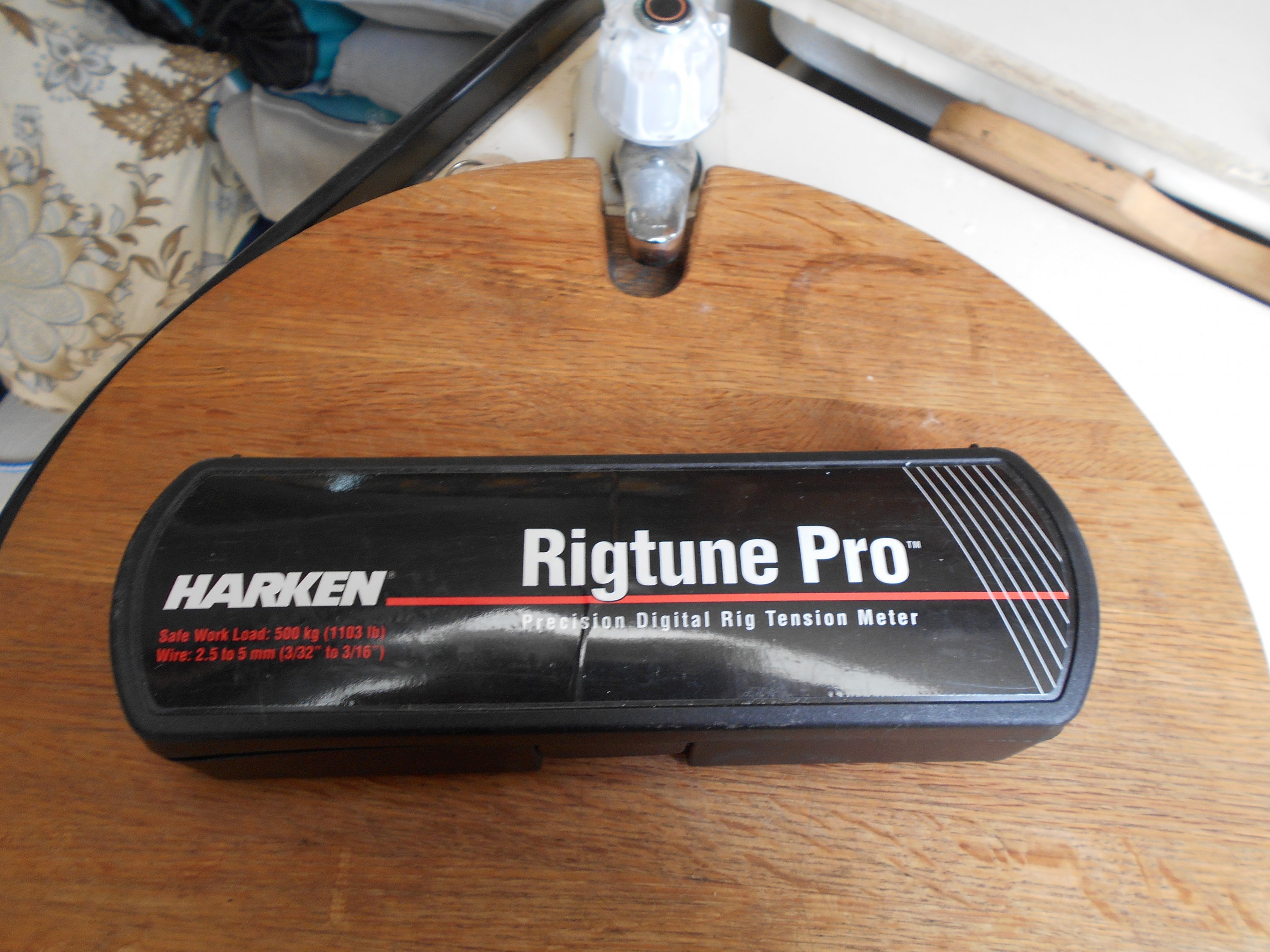

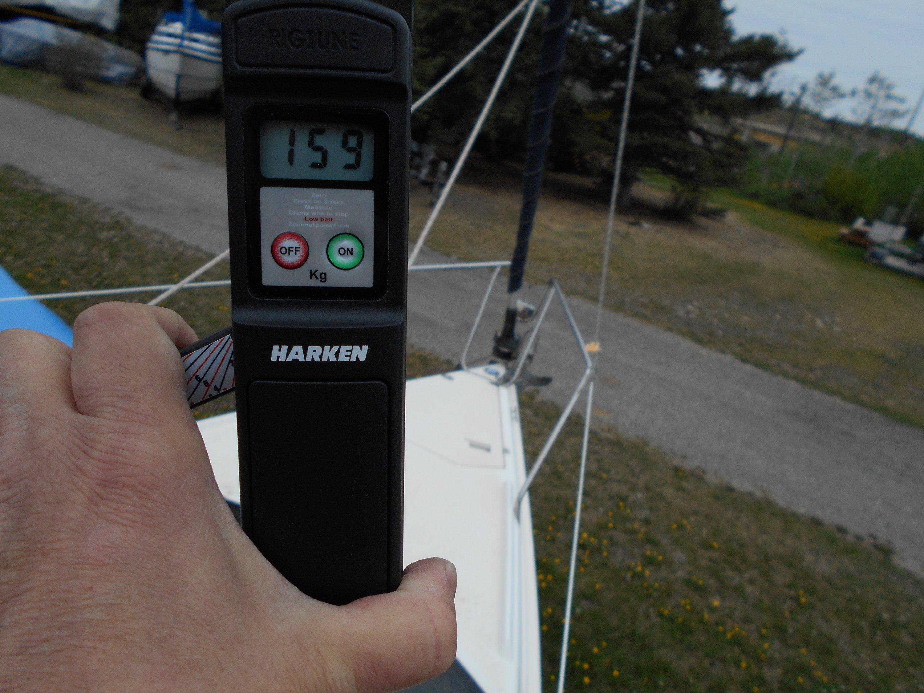

Hopefully you have your procedure figured out for setting the forestay length and mast rake before adjusting the shroud tension. I set mine at205kg (451lbs) for the uppers and 159kg (349.8lbs) for the lowers. After setting I rechecked under sail and found no reduction in tension on the leeward side with this set-up. Your results may vary so recheck for yourself. G
