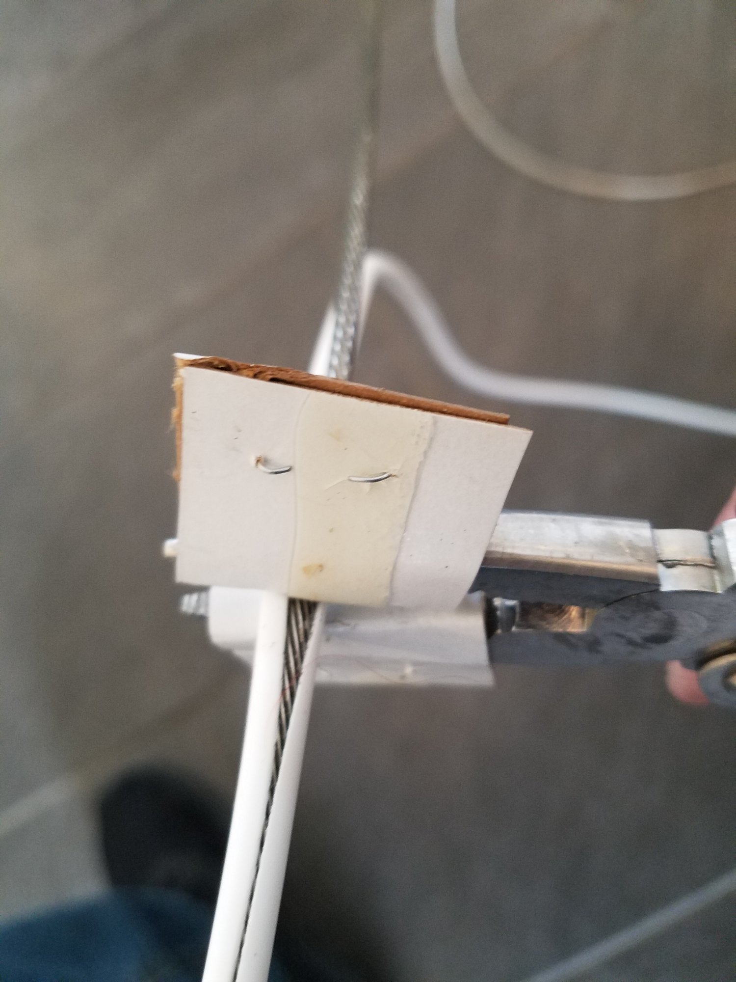

I had a similar issue after trying to replace my shrouds. As an architect, I'm used to solving problems like this one...Here is how I did it...20230424_142438_001.jpg
I ran a butter knife down the plastic sleeve slit just to make sure it was cut all the way.
Using a small thin-nose plyer, I bent some thin cardboard around each nose and stapled it tight...This will protect the sleeve from the teeth of the plyers.
A little pressure from the plyers will spread the sleeve apart enough to get it over the shroud
Working it up the shroud 1/4 inch at a time, you should be able to complete the installation in about 1/2 hour.

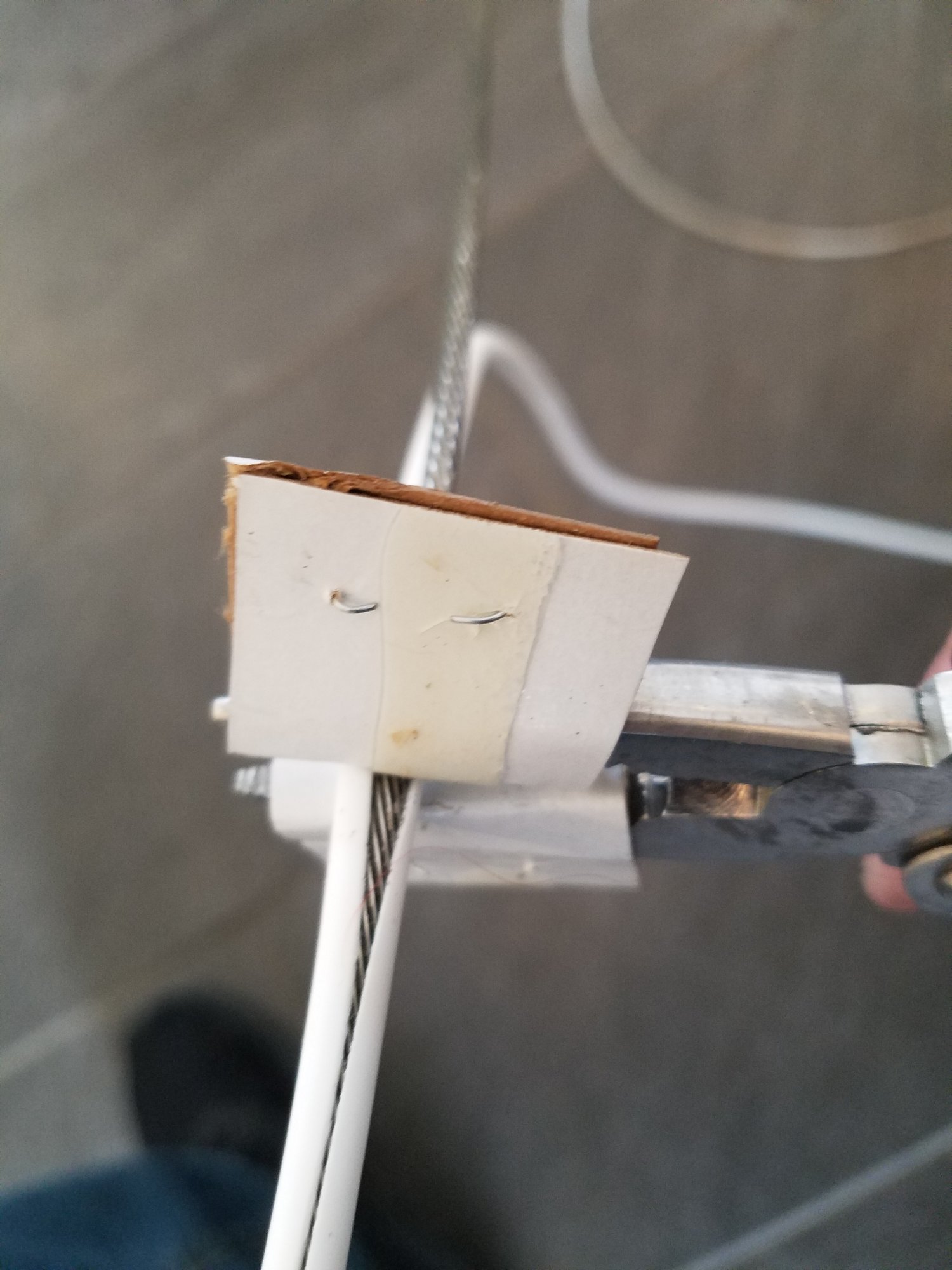

I had a similar issue after trying to replace my shrouds. As an architect, I'm used to solving problems like this one...Here is how I did it...View attachment 214981
