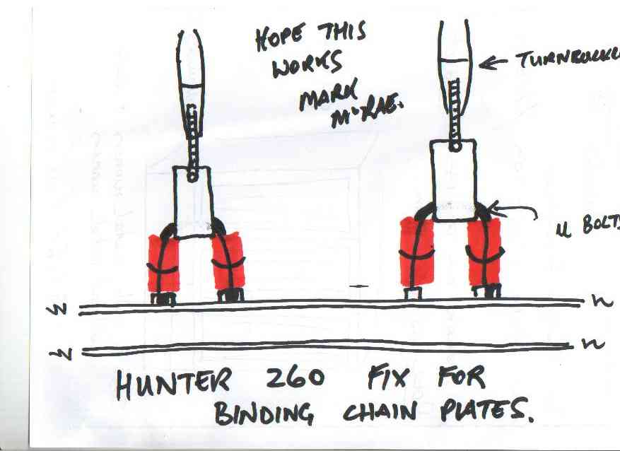

From time to time we read posts about the shackles (turnbuckles)getting caught on the chain plate "U" bolts resulting in them bending. Well after just 5 minutes and a peice of high pressure hose and eight zip ties I have solved the problem for ever. All you do is buy a length of hose with an inside diameter the same as the thickness of the "U" bolts and cut it into eight lengths (about 3/4 of an inch long) and then slit down one side. Push it over the "U" bolt (under the shround) and secure with a zip tie. Repeat on each one! We have used this set up now for several months and not once have we had a problem.

Would you post a picture of this?
I only drop the mast a couple of times a year for traveling but it does seem that there is an opportunity for improvement in this area. Do you mind sending a picture? I am having trouble visualizing your solution. Thanks, Doug

I will try.
In the past I have scanned a sketch for I haven't a digital camera. Hope the forum managers do not mind this approach?

Sorry Doug didn't work
Can you give me your email and I will send it through. Perhaps you are in the owner directory?

Done that Joe
But it gets to be a fag after a while for we step the mast every weekend and often during the week. These little pieces of hose can hardly be noticed and it is a permanent fix. No looking for bungees!

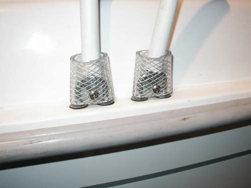

In reading the various fixes for the toggles on shroud turnbuckles I decided I would take a shot at an idea I had for a fix. From the picture you can see I used the hose idea that Mark suggested , but instead of splitting the hose, I just fit a 1.25" ID, reinforced hose over the "U" bolt. Then to keep it from sliding up I put a #8, 1.5" SS bolt and lock nut through the middle and screwed it tight. The hose extends up about 2 inches past the end of the "U" bolt and gives lots of support to the turnbuckles, while still allowing lots of play. I'll put additional pictures on the photo/project page and my sailing web site. Brigg

Now thats a good idea Brigg
Only thing with the one I came up with is that there is no need to undo the shrouds.

Brigg
True
True, but you only have to undo them once. I'd like to see a picture of how yours came out, since I borrowed your idea. By the way, thanks. Brigg
