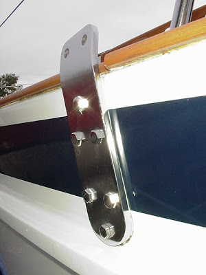

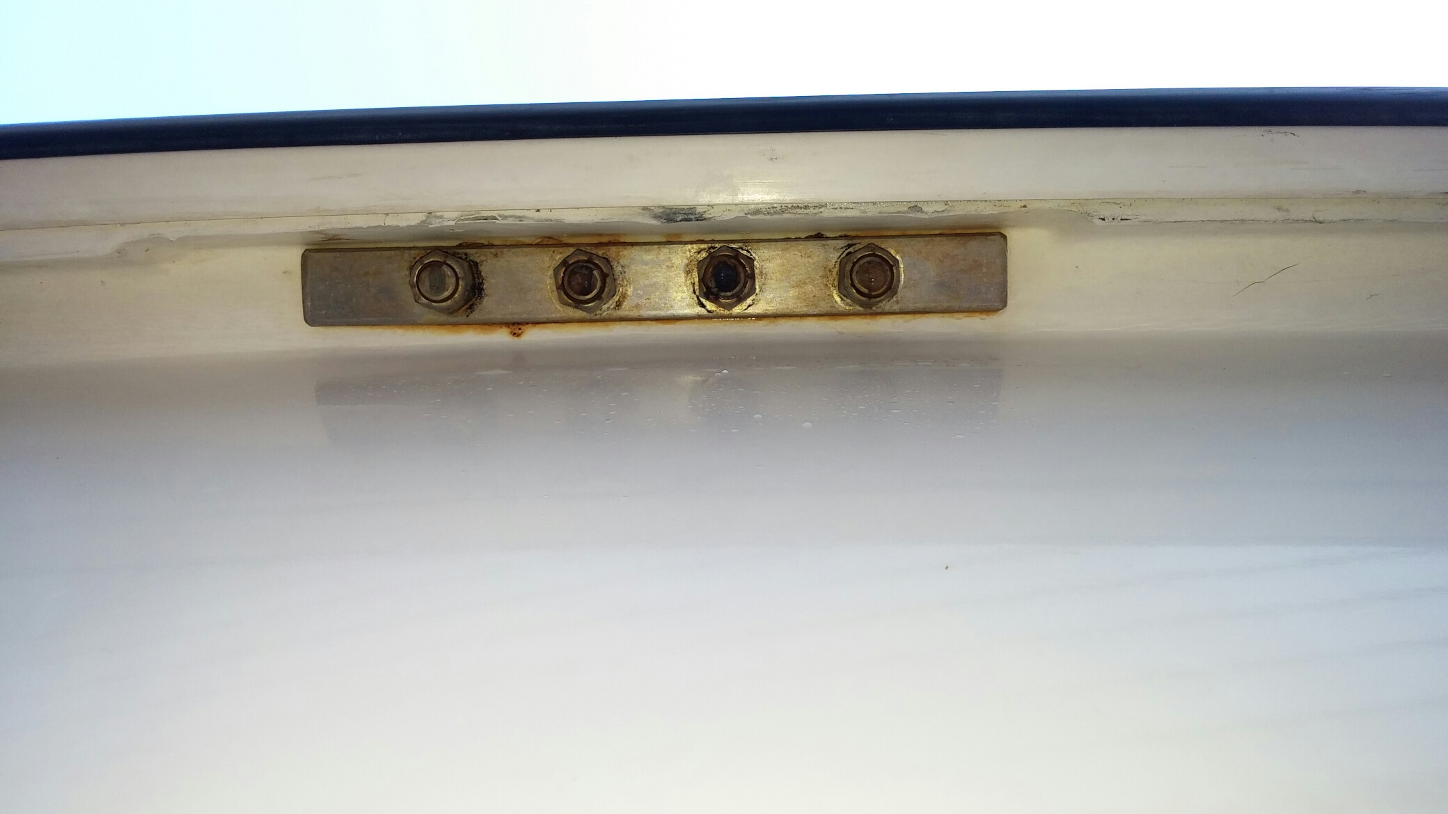

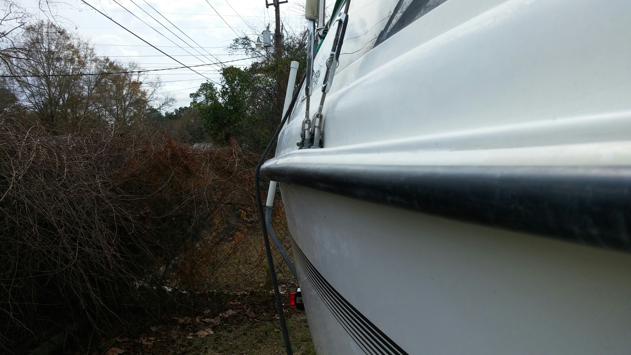

You need a proper "chain plate" rather than relying on those under sized backing plates. Chainplates anchor the rigging to a vertical surface, such as the hull or a bulkhead, that spreads the load to a wide area. I suggest you be a little creative and give some additional vertical support to your cap shrouds. Here are a couple of solutions... try googling "sailboat chainplates" for inspiration.

Going from memory, I'm quite sure there is a bit of material removed for my shroud backing plates as well. I think to allow them to fit flat and/or make room for a tool to fit the nut for tightening. I can't imagine that's unusual at all.

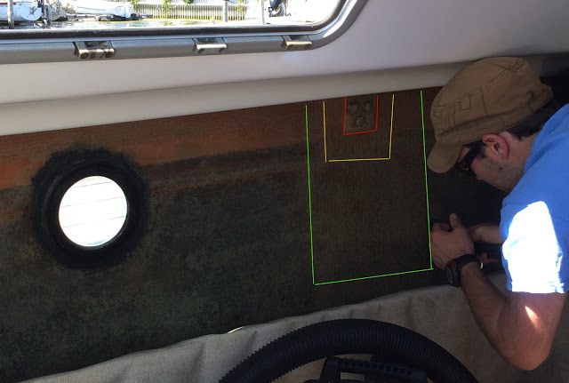

Indeed, that construction technique REALLY surprised me. While I haven't heard of a ton of Hunter 2xx rigs falling over, I'm pretty sure I would not want to push one as has as I would like.

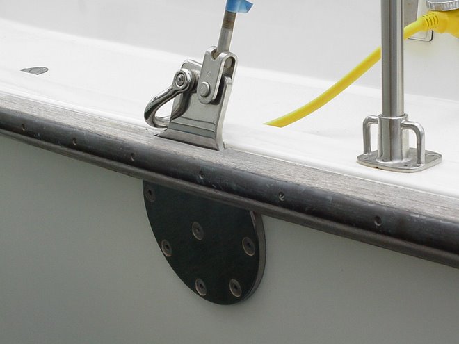

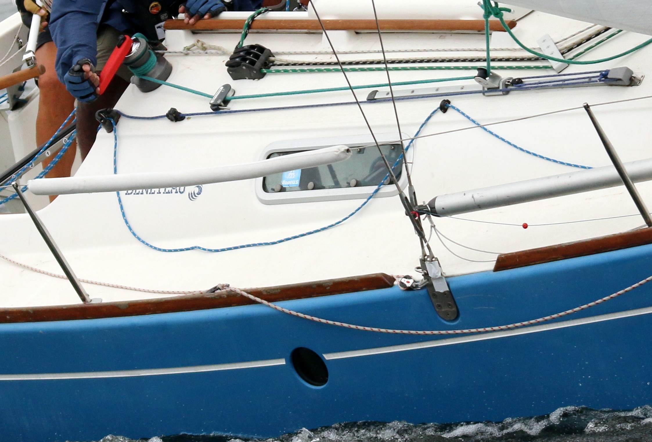

As a comparison, here is the outboard shroud setup on my like-sized First 260.
The first picture shows the outside detail, were the SS rigging plate is secured to the hull with 5 bolts.
More importantly, on the inside the laminate schedule was built up in this area to help spread the load. Each of the layered areas has been built up to take the rig loading. Pretty sure you could lift the boat with these two points.
Plates like these are easy to come by; you could probably make your boat much stronger with a rather straightforward mod. Do it right and you could re-use your shrouds!

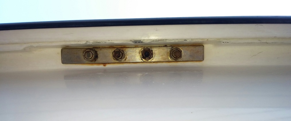

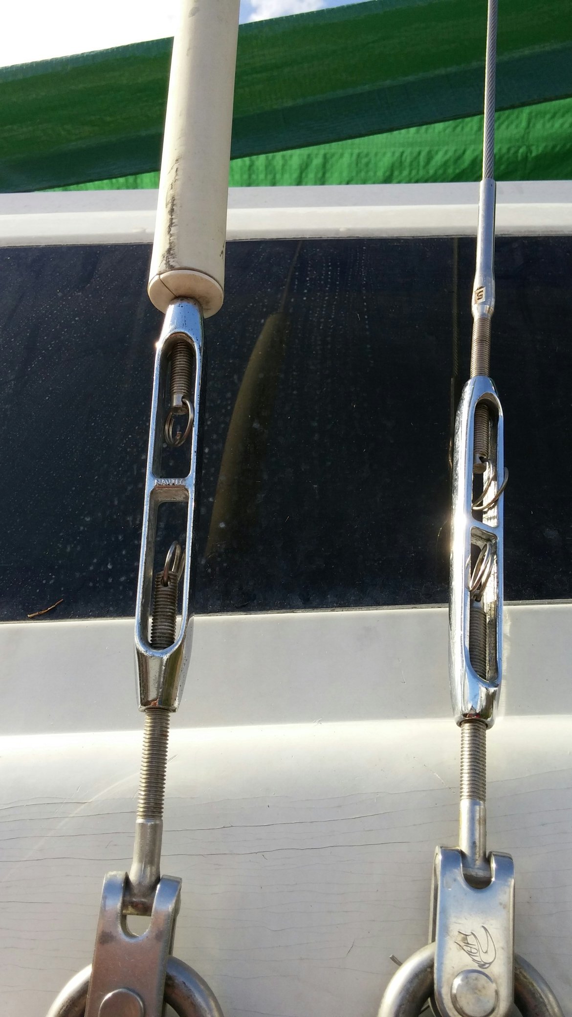

The system for attachment of the shroud chain plates worked quite well on this boat. Never heard of any failures but my original post was based on experience due to overloading by the previous owner with a larger sail and over tensioning the rig. Other than 1 crack in the gel coat I saw things but not to be alarmed. However a resolution as I pointed out needs to be addressed. Anyone who is concerned can take a high grade stainless steel rod of course round cutting it longer and drilling holes thru it to accommodate the chain plate. I would suggest a shop set up to do the drilling though if the owner is not set up to do that. I would use double nylon nuts backed up on one another to insure a safe locking so the first nut would not move securing the chain plate. The tension I also suspect is overloaded as well from what I saw in the photos as well. Even Frank and Annette who own Catalina and Beneteau were impressed with that attachment.

Thanks to Dave, and all the others that posted suggestions and concerns for this issue. Based upon your suggestions, I've come up with a plan of action to strengthen the structure and ease my mind of fear while sailing in strong winds. First, I will purchase some stainless steel stock same dimensions as original except in a 12 inch length. I'll have a machine shop drill the holes to ensure proper alignment and spacing. I'll then put everything back together using double self-locking nuts before seeking the guidance of someone more experienced and knowledgeable than myself for proper rigging/tuning. Lastly, until I can save to purchase/find/trade for a genoa with less power, I'll sail with the genoa only partially unfurled (hoping to retain use but expose less surface area of the headsail?) Of course, for those interested, I'll be sure to post the project and results here. I understand the reasoning behind a redesigned chain plate but am currently lacking in the funds/design and boat manufacturing understanding to take on such a project. I suppose it was my own ignorance of such things that made me so impressed when the previous owner proudly stated that the sails on the boat were just a year old and were good Peak Tri-Radials and *upgraded* 135 genoa with furling system. I can only assume that this new sail installation with the furler is when the rigging was likely overloaded. I've loosed the shroud turnbuckles and re-tightened in accordance with the instructions found here and the owners manual and deformation has now nearly disappeared. Now for the fix.

For what it's worth, I tension the shrouds on my 23 the way Dave has recommended - I do it by feel, so that I can pull the shroud sideways (each of lower and upper) about 1/2 inch by hand. That seems to not overload and the lee shrouds don't droop in a stiff wind. I don't have the same deformation issue, as the 23 has chain plates that penetrate the deck (it has a side deck unlike the 23.5 pictured here) and bolt to smallish wood bulkheads tabbed to the hull.
