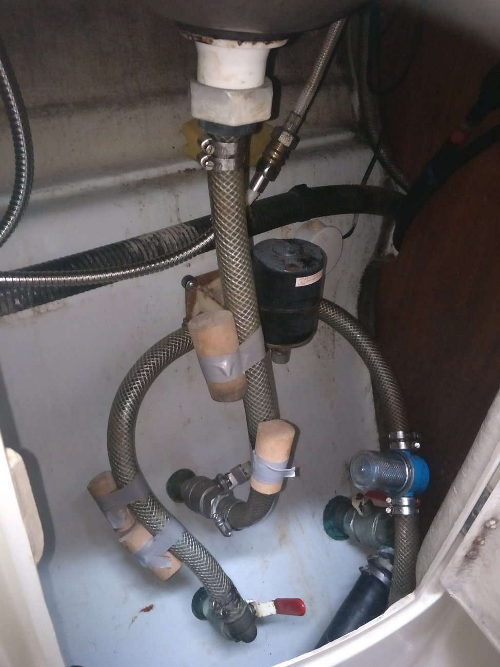

I just discovered a worrying design issue with my 1992 45f5 (hull number 94). When the filter on the forward shower sump pump got partially blocked it allows the line to be primed. The outlet is below the waterline so when the pump is turned off a syphon starts and would sink the boat!
In the past when the filter was clean air sucked into the line when the sump emptied so the syphon was broken.
My thoughts on rectifying this are:
  1. Turn the seacock of every time (a pain, but safest)
  2. Find/invent an electric seacock that fails to closed (violates the KISS principle)
  3. Keep the filter clean (not good enough solution for a sinking risk)
  4. Re-route line to above the waterline with a anti-syphon vented loop (relies on vent not blocking)
  5. move skin fitting to above the waterline. (a lot of work and not a good look)
Has anyone else had this problem? What are your thoughts?

I never noticed that on mine. I'll have to take a look at it, maybe install a loop with a siphon break but I'll keep the thru hull closed for now.

I would be interested to see if you have the same plumbing setup in the fwd head.

My setup is the same, I'll have to see if the pump drains or if it creates a siphon. I removed the holding tank from under the forward berth and am installing a new one in the sail locker. The old tank smelled up the whole cabin. All the head hoses were 25 years old too. The PO left the tank half full while the boat was laid up for 2 years. I do have a swim ladder but the swim platform is in the shop getting some fiberglass work done. I'll PM some photos when I get it back. Ironically, one of the repairs to the platform are chips caused by the swim ladder.
