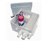

I’m looking for a solution (sorry if the title misled you into thinking I had one). Currently shower water drains into the bilge, where it collects and eventually stinks (bilge pump sits too high to completely drain the bilge). My wife and I like being able to shower onboard, as do my in-laws. Has anybody hacked this well? It seems if there were a pump that thoroughly drained my bilge, that would be good (in addition to addressing the shower grey water), but a sump solution at the shower drain might be more desirable, if possible. Seems both scenarios present pros and cons. Would love to hear others solutions, if any.

Route the shower drain hose to a shower drain kit, which has a pump and float switch, then discharge through a hose to a thru hull above the waterline. Requires a dc power supply, preferably from a dedicated panel switch. There are many manufacturers of shower sump pump kits, like Rule, Attwood, Seaflo, etc. with different pumping capacity.

The self-contained sump and pump is commonly used on many boats. On the other hand, many European-designed boats including Beneteau, directly connect a pump to the shower drain and pump overboard via thru-hull. In both cases, you need a new thru-hull. Both systems will work as long as you have 12v, and the space for either the sump/pump combo or the pump alone method.

Route the shower drain hose to a shower drain kit, which has a pump and float switch, then discharge through a hose to a thru hull above the waterline. Requires a dc power supply, preferably from a dedicated panel switch. There are many manufacturers of shower sump pump kits, like Rule Attwood, Seaflo, etc. with different pumping capacity.
Seems I could fit one in the bilge, where the shower hose currently exits, then route the output into a t-connector on the galley sink drain (seacock below the waterline) with a vented loop above the waterline to avoid siphoning my boat to the ocean bottom. Any reason this isn't a good plan?

Agree with Sail SF on the shower drain kit so the shower water never gets into the bilge. Alternatively, getting the last bit of water out of the bilge is difficult with a bilge pump and a long length of hose - here's an interesting solution: Build Your Own DIY Arid Bilge or Dry Bilge System

The shower floor is likely below the waterline, so you need some kind of pump to get the water out, not just gravity.

On my O’Day 322, there is no room under the shower floor for a box or a pump. The builder put a hose off the shower drain fitting, to a diagram pump under the vanity, and it pumps the water out of an above-the-water thruhull under the vanity.
The pump is loud, and it needs to run while showering, but it effectively keeps shower water out of the bilge. Maybe I need a new pump, but I don’t shower (on the boat) that often.

I have pump that send shower water over board and hose from shower drain goes to pump with switch to turn on pump when showing and my shower area has depth to allow water to sit below wood grate and pump
like pump that can run dry and works great on my boat.

Thanks for the replies. As the shower drains into the bilge, and it will be difficult to route it to the head sink seacock, I will install the sump pump in the bilge and run the output up to a vented loop under the galley sink, then T it into the galley sink drain, where it will drain below the waterline. Seems the only way.
