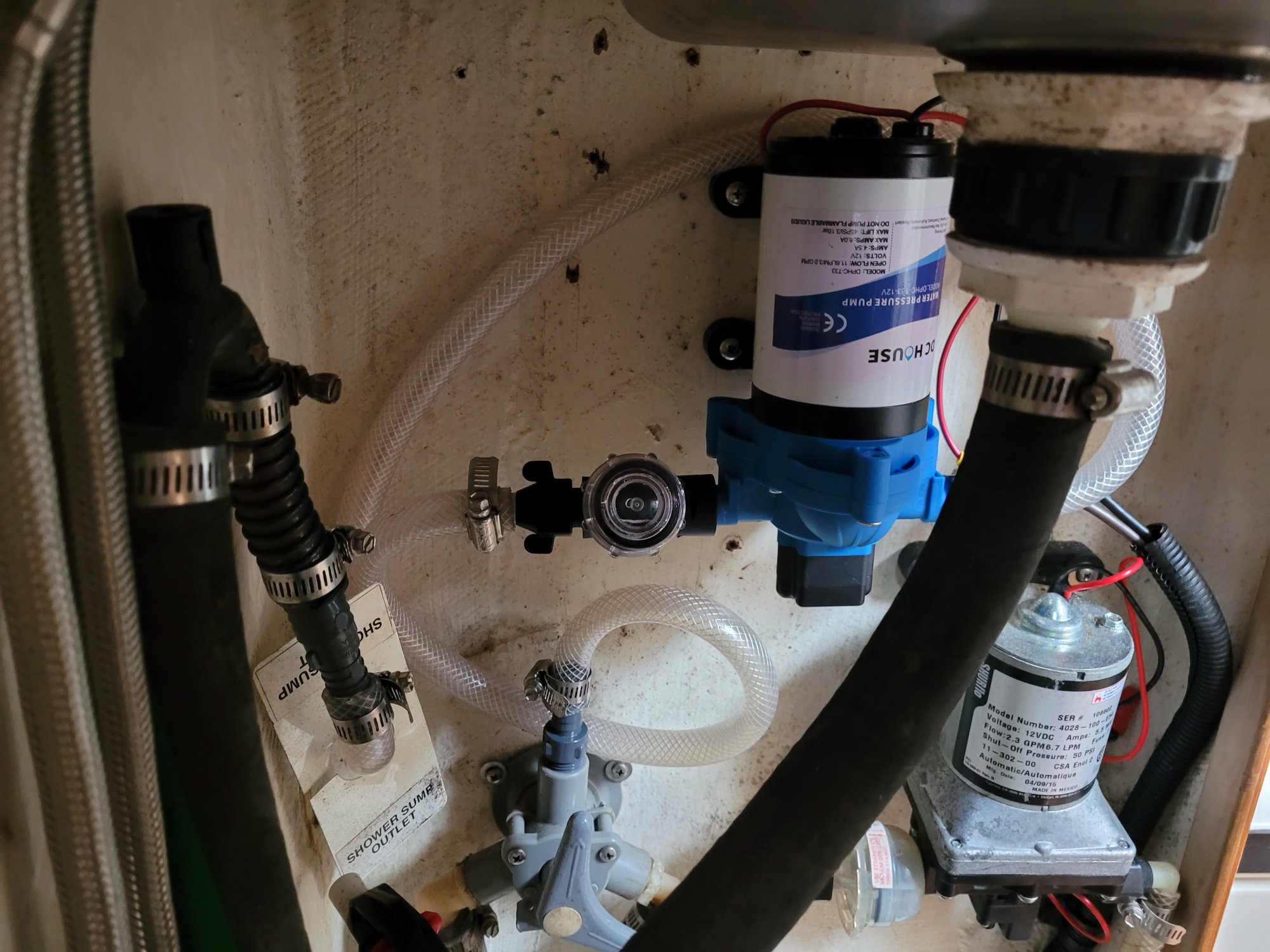

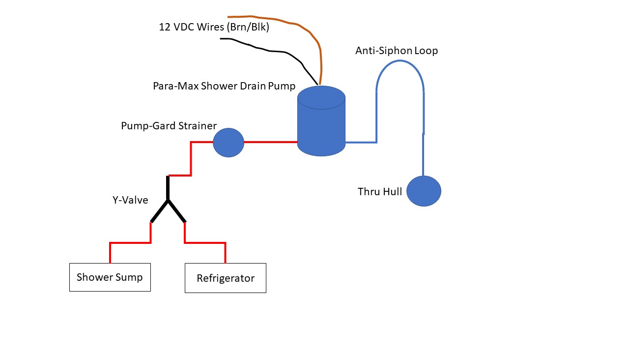

My shower sump is not working. Pump runs, I took the hose off where it connects to the Pump-Gard and blew through it and it seems to have a good seal. The one hose I did not check was the outlet of the Pump-Gard strainer to the inlet of the Para-Max pump (instructions say that these hoses should have no leaks so the pump can self-prime and draw). I did take the pump out and inspect and everything looks fine. Thoughts?
