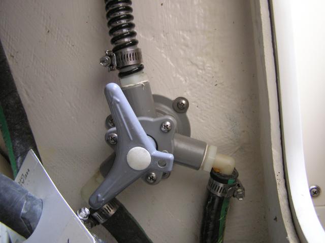

I found an old thread on this site that discussed this somewhat but I am still not 100% on how to pump the shower gray water overboard.
Anyone have a suggestion? I have a "Y" valve under the head sink. It seems like the shower sump drains with this valve in either position (with the head seacock open) but I don't know if it goes overboard or into the holding tank. I prefer to have it discharge overboard.
If I were able to fit inside the cabinet under the sink, the valve would turn clockwise or counter-clockwise when facing forward relative to the boat (how's that for a mental image :))
I am assuming that this valve is directing the shower sump to either the holding tank or overboard? My last ditch idea for figuring this out is going to be to dump the contents of a chem light stick into the shower sump and see in which position I light up the water around the boat:eek:

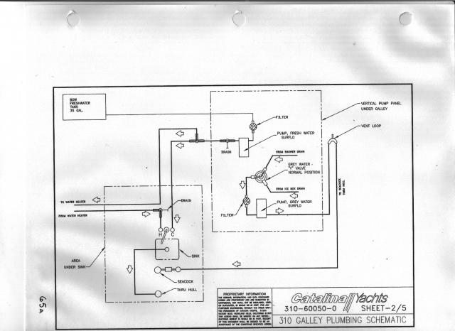

Thanks Paul,
Excellent help! My set up looks just like that except I have a manual head.
So do I understand this correctly that the joker valve is what keeps the shower and/or icebox drain from emptying into the toilet and makes the through hull the only escape as it were?

Not how mine is done, I have a seperate thru hull for the shower/ice box drain, fed by the same "Y" valve.

Your results based on hull # may vary, but I suspect most are set up this way. The ice box and the show each have a drain line. They go through they "Y" valve, then a screen filter, then the pump, then a vent loop and then into the through hull and overboard.

Thanks everybody, the sketches were priceless. Saved me from dumping the chem light in the shower.

Mine is the same way. The Y valve for the shower sump is in the galley and is used for shower and fridge drain. I have a Y valve under the head sink but it is set up for draining sink water from the head sink to discharge or I can set it to take fresh water from the head sink and send it to the toilet for fresh water flush. I believe that was a PO modification though. (it really works well!)

Silvio, on my 310 (hull # 215), the Y-valve is under the galley sink. This valve is used to drain the shower sump or the ice box. It always empties overboard, all you do is decide if you want to drain the shower or the ice box by using the Y-valve. Looking over the manufacturer's drawings, that is exactly what they intend. Maybe in another series the Y-valve is in the head, but probably both empty overboard.
