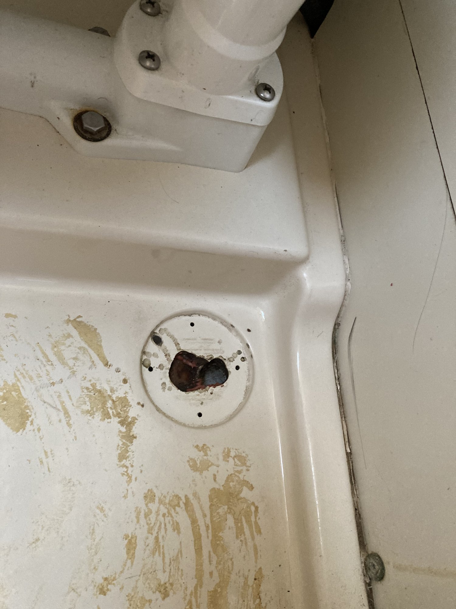

Hard to tell from the picture, but my guess is that there’s not room between the pan and the hull at the low point.

Ah, back to the shower drain by the head. Let’s face it the 1991 Hunter 28 was not very well designed for taking a shower unless you want to flood your soul and ruin your lower interior wood work. Thinking of installing a little pump that will push water up to the drain by the head or figure out a gravity way to the bilge. Any thoughts, suggestions?

Not familiar with a H28, but if you have room under the shower pan for a bilge box, you can put a bilge pump in there and then route it overboard.
On my 1988 O’Day 322 There is no room under the pan. I have an elbow directly under the drain, and I have a diaphragm pump under my sink cabinet. The diaphragm pump will pull the water from the hose under the drain ( doesn’t need to be primed), and push it overboard. The pump has an on/off switch in the head, easy to turn on and off when showering. Generally i would run the pump while the shower is on. The pump can also run dry and it won’t hurt it.

Well that’s dumb and it looks like there’s a recess for it too; not just a guy with a drill having a bad day.
If there is enough clearance under the low end of pan, relocate the drain, fill the original hole and maybe put a nice teak or starboard shower grate over it all. Best to plumb the drain to a shower sump box with a pump. You don’t want your shower draining directly into the bilge.

Yes, there is a recess and a pvc 90 degree elbow you can almost see connected to a hose which of course goes directly to the bilge. No clearance under low end! But I like the teak grate idea! I would have to fabricate a higher lip for existing shower pan…
