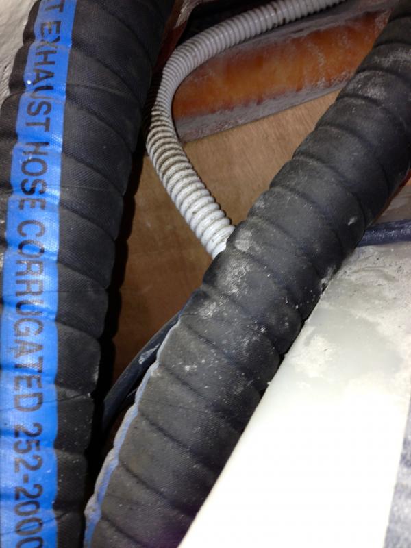

I spent some more time on the boat trying to find where the drain hose connects. Will try to upload couple of photos. Drain goes into the bilge where the manual bilge pump pick up is located but as I hope can be seen from the photo it is joined to a second drain hose heading aft. It appears to go back to the holding tank again i have attached photo. Being single handed I couldn't positively identify the hose as being the shower drain hose but certainly looks like it. Arm not long enough to reach into the locker far enough to grab hold of it it seems to head up behind the holding tank. There is no pump fitted I'm sure so as an interim solution I have disconnected to joint in the hose and run it drains directly into the bilge. Will keep on with the investigation next time I have an extra pair of hands available. Cheers guys.
