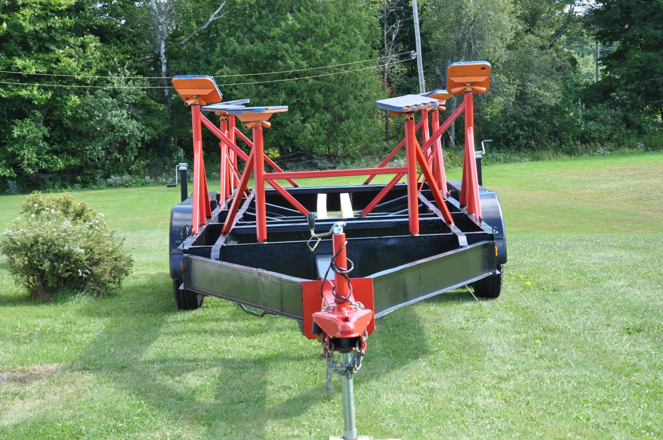

CSNB try this one out, used to haul my 35.5 with no issues and then modified to haul the extended length of the present 40.5.
Tri-axle, electric brakes on all wheels, lights, hitch and safety chains are all highway legal, trailer has been inspected each year with no issues. I can get you the measurement the next time I'm down to check on the boat. Will find the pix and download.
Jul 19, 2007
262
-Hunter 1995-40.5 Hunter Saint Andrews, New Brunswick, Canada
Here are the pictures of my trailer: DSC_0031.JPG DSC_0031.JPG Wooden inserts will hold the small skeg on the keel just off the center shoe and will allow you to center the boat on the bulb. Stabilizer jacks on the rear of the trailer allow for more trailer stability if your on uneven ground in the yard with the boat on the trailer and in summer I use them to lift the entire weight of the trailer off the suspension along with the tongue jack. All eight (8) stands are adjustable and can be lowered side to side to allow for putting on anti-fouling paint.
