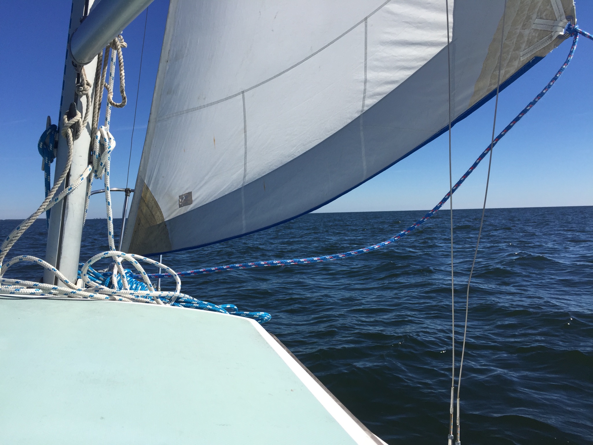

Should the stays be this loose
Oct 21, 2014
190
Oday 22 Richmond
Good morning. I was sailing yesterday in the Chesapeake bay and not doing much other then staring into space. I noticed that the leeward shrouds are pretty loose. I would expect this some but do these shrouds look too loose in the accompanying photo? My last sailboat had 1/2" phosphor bronze shrouds and I never noticed any sagging at all. It could have been because they were so heavy. Thanks.

They look pretty loose but we'd need to know some additional information.
1. How much tension did you initially set them at when you rigged the mast? If you used a Loos tension gauge, what percentage of wire breaking strength did you set the tension for.
2. Did you just rig the boat or has it been rigged for a long time? If you just rigged the boat, there will be a period of time when the wire will stretch and the boat will change shape. This will effect rig tension.
3. Have you checked the tension after rigging and sailing the boat in a 10-15 knot breeze? You should check and adjust the tension after you have sailed the boat in some decent wind.
4. I assume your mast is deck stepped. Is there any deck compression in the area around the mast step? If the deck is cored like most decks are, water could have saturated the deck at the mast step and caused the mast to settle thereby causing the shrouds to lose tension.

Your vertical shrouds should NEVER go slack. Ever.
Your diagonal ones can (slightly, under wind pressure) depending on rig tension.

Thanks for the replies. I did not use a gauge to set them up and no they are not new.. The compression post and deck are in excellent condition. This is not something that happened all of a sudden. I'm sure they have always been this loose and I just never really noticed it.. Last week I was out during that nor'easter and the wind was blowing steady 20 knots gusting to 30. I'm sure they were just as loose then I just had other things to think about (like should I reef). I believe this is the case Jackdaw. In the picture you can see where the vertical shrouds are still pretty tight where the diagonals are a bit floppy. I might snug them up a bit this week. Thanks again.
Do you mean front and back stays, by "vertical" shrouds?

David, the cap shroud in your photo appears to be "kinked" about a foot above the turnbuckle terminal. And it looks like it could also be kinked slightly at the terminal. I would consider replacing it. This is a fairly common occurrence on trailer sailboats where they are rigged and derigged many times. Kinks leave gaps between the strands in the wire allowing for moisture to accumulate and crevis corrosion to take place. I had this happen to a headstay which ultimately broke while under load. If you elect not to replace, monitor it closely and definitely replace once you see a broken strand.

Leeward stays should always be taut! If they are not, coming about, or gibing can result in shock loading of the stays, significantly increasing the probability of losing the rig.
You can use a Loos gauge to set the stays to the recommended tension. Or, you can take up the slack on the leeward side underway in a good wind, remembering how many turns you made to the turnbuckles, and tightening the windward side the same number of turns when it becomes the leeward side.
Our procedure is:
Check the position of the top of our mast: left to right using a measuring tape, and a halyard to the toerail, and fore and aft to get the right rake (4% is a good starting point.)
Sight up the mast to ensure it is in line, top to bottom. Adjust the lower stays until it is.
Tighten all stays equally on both sides until the tension (measured by the Loos gauge) is up to the standards for our rig. 425 for the lowers, and 480 for the uppers for our 3/16ths stays if I remember correctly.
More complicated rigs require more complex procedures. I'm sure other members can guide you to a procedure for your boat if you don't have one.

Are there jamb nuts or kotter pins to hold the turnbuckles from twisting loose? Something like that missing or loose could allow the shroud to go slack. RE: vertical shrouds..........The upper shrouds that go nearly straight up from the deck to the outboard end of the spreaders and on up to near the top of the mast.

Thanks again for all the replies. Seahorse there are jam nuts on the turnbuckles and I do keep an eye on them. There are a few kinks in the shrouds and this winter I intend to look into what needs to be replaced. I have inspected them and even though they are slightly bent they are not unwinding or anything like that. Some things are necessary to be replaced and some not. Something as important as the shrouds is on the top of my list. I suspect these may be the original shrouds (1972) since the original owner never replaced them and then she sat on the hard for 10 years. She is not a racer as you all know. I don't really see much value in fine tuning the rigging but I don't want so much play that things get violently pulled due to slack taking up. The mast is straight and that's fine with me although I know there are a lot of people who tune the mast with the stays for optimum performance. For me getting out there and getting back is my main goal. The water pump on my Honda 4 stoke gave out on me Sunday night and I got back to the slip at 4:00 am. Wind dropped to near dead calm in the late afternoon which it does in these parts normally. Long day but it was beautiful weather and just about as peaceful as one could imagine.
