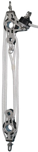

Thanks, excellent links.... being as the boat in the video is running a boom vang it make me wonder why the previous owner would get rid of it. Now to find a decent priced replacement.
If you build your own , using 1/4" line will save you a lot of money since the required fittings can be smaller. However, you might want to check out the prebuilt vangs from Garhauer Marine which were common on many Catalinas. Check their website … prices are pretty good.
Here's a 4:1 unit that uses 5/16" line. More than adequate for your boat. A good price at $125.
