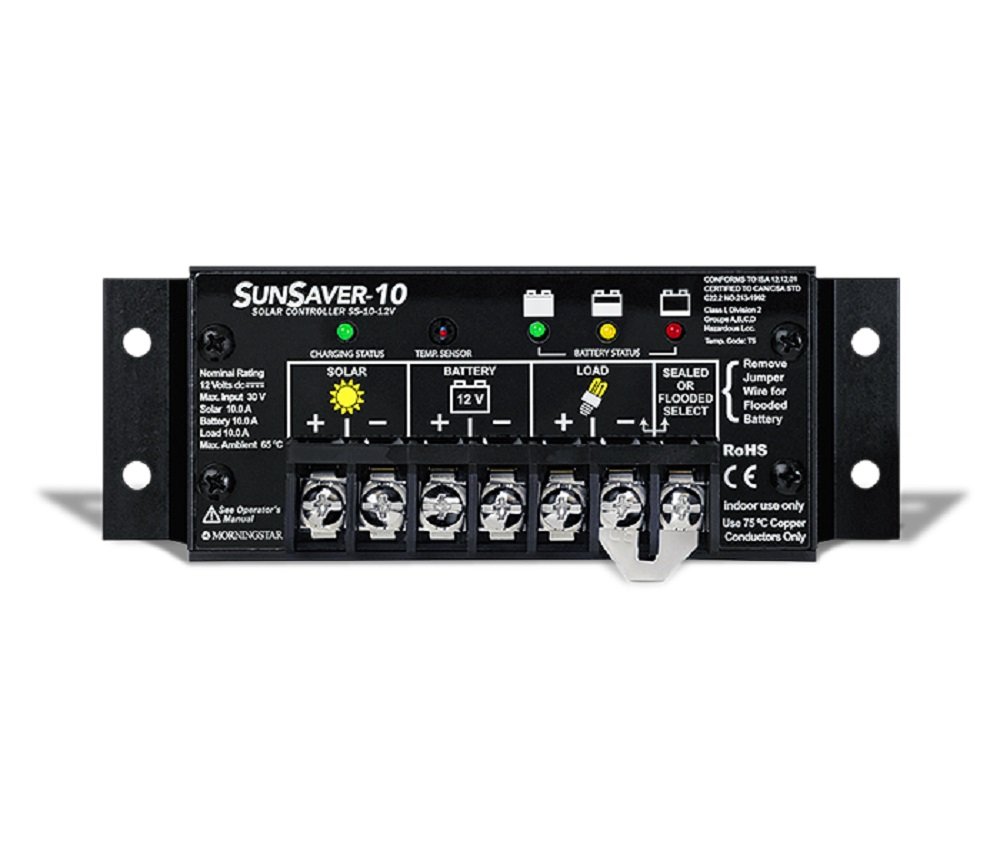

FWIW, I'm using a SunSaver-10 controller rated for 30 volts max input, and a single group 24 "Duracell Ultra" flooded battery.
So. Series, or parallel??

There is only one set of input terminals on the controller. Just piggyback the wires onto them?

You definitely want them in parallel. In series with one in the shade it would then block the current from the other panel down to what it is putting out at that time.
You could piggy back the wires but......
..... I'd run them to a terminal strip with jumpers connecting the terminals on one side for (-) and the other for (+). Place the terminal strip by the controller then a single set of wires from it to the controller . Make sure your wires are sized for the run so you maximize the panels output....

Yes, parallel. Series doubles the voltage but keep the current the same. Parallel doubles the current but keeps the voltage the same. So if both panels produce 17vdc at the controller, you would have 34vdc when you connect in series.

FYI, that controller is PWM so you really have no choice but to parallel connect the panels. If the serial connected panels didnt damage the controller by exceeding the 30 volt input spec, you would still only get the power of a single panel even without shading. No need to worry about any diodes, just connect both panels in parallel to the controller solar input. Use the bus or just one lug on top of the other then screwed down. If you are removing one or both panels often, the buss would make things easier.

One little caution with that controller (since I burned a very similar one out). If you have a panel in the sunlight connected to the controller and the controller is connected to a battery, shorting the solar panel side will burn out that controller even if you have some sort of fuse in that line. I mention this as you may have one panel already hooked up and would be adding a second. A little slip that shorts the panel side with the hot system will make the controller junk. If you accidentally short the battery side you should just blow a fuse. The solar side even with a fuse is very sensitive when its running!!!
I once saw a suggestion to put a towel over the panels if your connecting them to a hot system in daylight.. not a bad idea. If you accidentally short the panel side when they are not producing any power (like at night), no problem, nothing will happen.
You probably were going to be more careful than I was... but worth mentioning. I burned mine out messing with two panels..

All righty then, parallel it is, thanks everyone! Glad I asked, because I was planning to wire them in series. :redface:

PS and thanks Walt, that's good advice. I'll throw dark towels over both panels while I'm messing about with the controller.

Morningstar equipment is pretty bullet proof. For maximum efficiency I would use two controllers and parallel the outputs. I believe that is what they suggest also but it may not be in the budget.
Gene, I spent a lot of time pondering (that means sitting in the cockpit with a glass of wine.) my installation on my two aft bimini bows with two panels. Series/parallel- which to do. SO, I ended up having it both ways with a couple of DPDT switches by the nav station. My Morningstar controller is rated for more voltage than the two panels in series.
If wired in parallel, when the voltage from the panel reaches a certain low point (say, 12.6) the batteries are no longer charged. But if you switch to series, the voltage doubles and I can squeeze every last amp before the sun goes down- or when the sun comes up. It is not too often I am that needy, though. My 2 cents.
